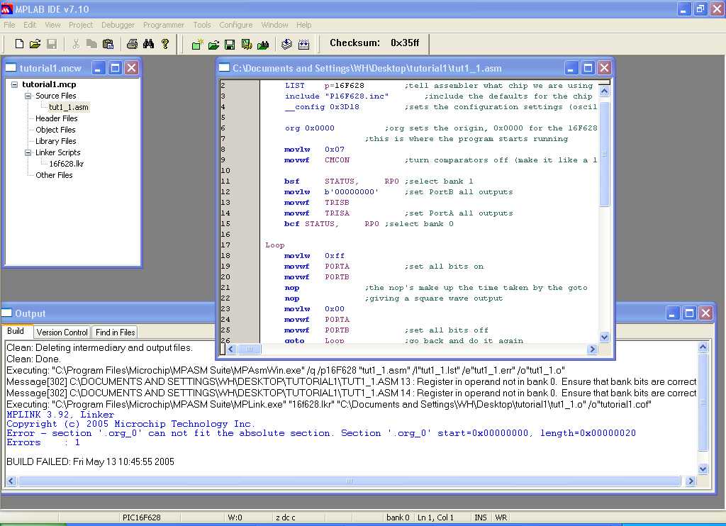

Ok. So i finally got my programmer. and to my knowledge its working.
SO i've been doing Nigels tutorial and tried compiling it with MPLAB IDE 7.10
I followed a short tutorial on how to use it on microchip website. and used their device (18f452), linker (18f452.lkr) and code (used template and added to it f452tmp0.asm) and it worked fine, Now its my turn following the same steps:
- used the project wizard
- chose my device (16f628), project name and location, tool suite,
- chose my source file (nigels tutorial 1-1) and the linker file (16f628.lkr)
Then tried to build it all and got this error. I even tried using the template and that still gave an error without me editting the template, WHAT THE HELL !
soo can someone pls tell me what i'm doing wrong or missing. Notice it says "TRISB isn't in bank 0". I nigels code isn't editing bank 0, it tries to edit bank 1

Sorry, but I never use MPLAB (it seems FAR too complicated), I just use it's assembler MPASMWin, which is installed along with MPLAB - installing MPLAB seems to be the only way to get a recent version of MPASMWin.
If you're following the same steps as you did for the 18F chip, that could be a reason for the problem? - the 18F chips are quite a bit different, and MicroChip introduced a number of different options for them.
The bank switching 'message' isn't an error, it's just a warning to remind you that you're trying to access a register not in bank zero - it takes no notice of the fact you've just switched banks!. You can turn this warning off, and my later tutorials do so.
To use MPASMWin you simply run the program, select the assembler file you want in the requester (or type the path and name directly), and press the assemble button - it's that simple!.
The problem is wrong placement in program memmory. Make sure that sections fit in their locations (eg Interrupt routines). Also make sure your start vector is placed AFTER the ISR... (Use "ORG" to place certain code at certain Address)
Ignore thoose Warning messages, they are only informations, so you won't forget to place correct banking instructions in your code. If you don't want to see certain Warning, add this to your config:
	__CONFIG	_CP_OFF & _WDT_OFF & _PWRTE_ON & _BODEN_ON &_XT_OSC & _MCLRE_ON & _LVP_OFF ;ignore this, it's for 16F628
	ERRORLEVEL -302 ; disable banking warning

Yes, I use Pure MPLAB Tools 7.11. I found it dfficult to move from old 5.40 versions to new 6.x and 7.x. But now it's not a problem for me. So I understand your frustration! (Took me a while to get it all moving.) It seems like you are doing everything OK about MPLAB. please post your Code, and I will try to add ORG sections where needed.

Don't use the Linker...
Regards, Mike
Wow.. that is an interesting way to solve the Linker problem, just dont use it.. Its GENIUS !!!
I would never have thought of it. I can now use the simulator..

I find linker prety usefull. But if you don't need it, don't use it...

If you are working on a BIG and complicated project you will want to write object code in stead of absolute code in wich case you NEED mplab.
But indeed for simple projects mplab adds extra difficulties.

I know that probably sounded flippant, but I've only written code in absolute mode these first 15 or 16 months... A couple projects with over 1,000 lines in a single .asm file...
I'm sure I'll probably get into multiple files, relocatable code, and the linker sometime in the future as projects get larger...
Good luck... Best wishes... Regards, Mike

To the extent of my knowledge, the linker 'links' code separated among several files together to form a single object code, or binary file... And I don't think you should pass the 1000 lines to be 'elligible' to use the linker. If you have extensible program, want 2 make it upgradable, or just like to separate bigger task into smaller ones, the linker could come-in handy...
