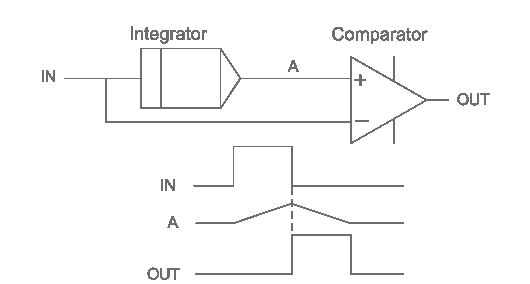

Conceptually, the attached circuit does the job.

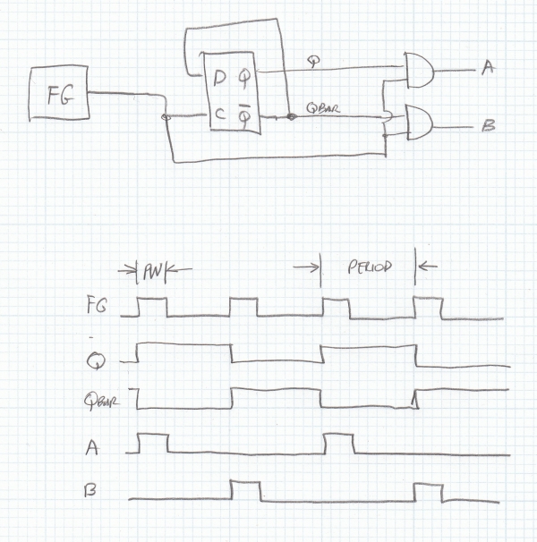

If you have a function generator that has independent control of frequency and pulse width, connect it the Clock input of a positive-edge triggered D Flip Flop. Wire the Qbar output of the DFlop to its own D input. Q and Qbar are complementary.
Now if you want to shorten the two complementary outputs to be the duration as the pulse width of the function generator, wire two AND or NAND gates so that the Q and Qbar outputs are gated by the function generator signal. Now adjusting the pulse width on the function generator gives you control of how long the two outputs last.
Good stuff guys I think both of these ideas will work and be quite easy to construct as well.
Ive been in a meeting all morning and have not been able to put any time into this project yet. After lunch time I will take a closer look and most likely use something similar to the design with the D F/F. I need to get some more solid specs on what kind of signal I need to generate for this pulsar circuit from my colleague.
