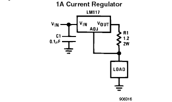

The circuit below is right off the **broken link removed** Basically, the resistor shown programs the current. If you want exactly 0.3A, the resistor should be 1.25/0.3=4.166Ω. A 3.9Ω resistor would make the output current 1.25/3.9=0.32A. If you wire three of your 3.3V 300ma LEDs in series with the cathode pointing to ground, the drop across all three will be 9.9V. 1.25V is lost across the resistor, and ~1.7V is required for the regulator to work (Drop Out Voltage), meaning that it will regulate properly if the input voltage is 9.9+1.25+1.7=12.85V or higher, which is the case if your engine is running (alternator voltage is set to 14.2-14.6V) but not if the engine is stopped (resting battery voltage is 12.65V).
As a practical matter, it will work with the engine stopped, but the Leds will be a little dimmer.
The worst-case power dissipation in the LM317 with the engine running will be [14.6-(1.25+9.9)]*0.3 = 1W, which if you use the TO220 package you can get by without heatsinking it. (Not true if you only use one or two leds).

I have a few questions though :)
First thing is, the regulator works but check what the voltage drop is and then regulates that exactly? I ask this because I always thought an LED would take more voltage if given more?
Second thing is, what is C1 0.1uF in that diagram/also voltage dropout pointed to the ground? What does that mean sorry for my ignorance
Third is, the resistor MUST be mounted in one way only, because polarity matters correct?
Finally, it says LOAD after the resistor. For the negative of the LED's and the positives, where do I connect? I ask this because these diagrams only show one line going to the Load of the circuit. Thank you!

The C1 thingy is a capacitor and is needed by the regulator for it to work correctly..Dont omit it. It can go in any way round as long as it is not an electrolytic...polyester or similar is ok
The resistor is non polarised..it can go in any way round...
The load is your led(s)...
Connect the led -ve to ground and the +ve to the junction of the resistor and Adj..

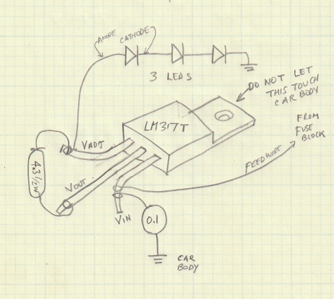

The resistor is dissipating E^2/R=1.25*1.25/4.3=0.39W so a 1/2W resistor is more common and cheaper.
C1 has to be purchased (look here).
When mounting the LM317 (TO220 package), it cannot short to the car frame. I would screw it to the car body using a nylon screw, with an insulating mica washer between it and the car metal. That way, no heatsink is required.
btw- reading some of the previous posts, only the heat produced by the regulator itself and the power dissipated in the resistor is conducted to the "heatsink". That power is ~1W in the regulator and ~0.4W in the resistor for a total of 1.4W.
OTOH, each LED is mounted someplace else, and it dissipates 3.3*0.3 or about 1W, so Carl is right, you will need to devise a mounting for each LED which mounts it mechanically, but conducts heat out of it to the car body.
The resistor can go either way around and be soldered directly between the Vout and Vadj pins.
The capacitor I show above is not polarized, and one lead should be soldered to Vin and the other grounded to the car body near the regulator.
The LEDs are polarized; one lead is called anode, and the other is cathode. The string of three LEDs is wired anode of 1 to Vadj;
cathode of 1 to anode of 2;
cathode of 2 to anode of 3;
cathode of 3 to car body. If you are mounting the three LEDs in different locations, you will have to daisy-chain a wire as needed.
Power feed wire to Vin. Connect other end to fused connection in the car's fuse block. 1A fuse is sufficient.

This is extremely helpful, I appreciate you took the time to draw a diagram I completely understand.
