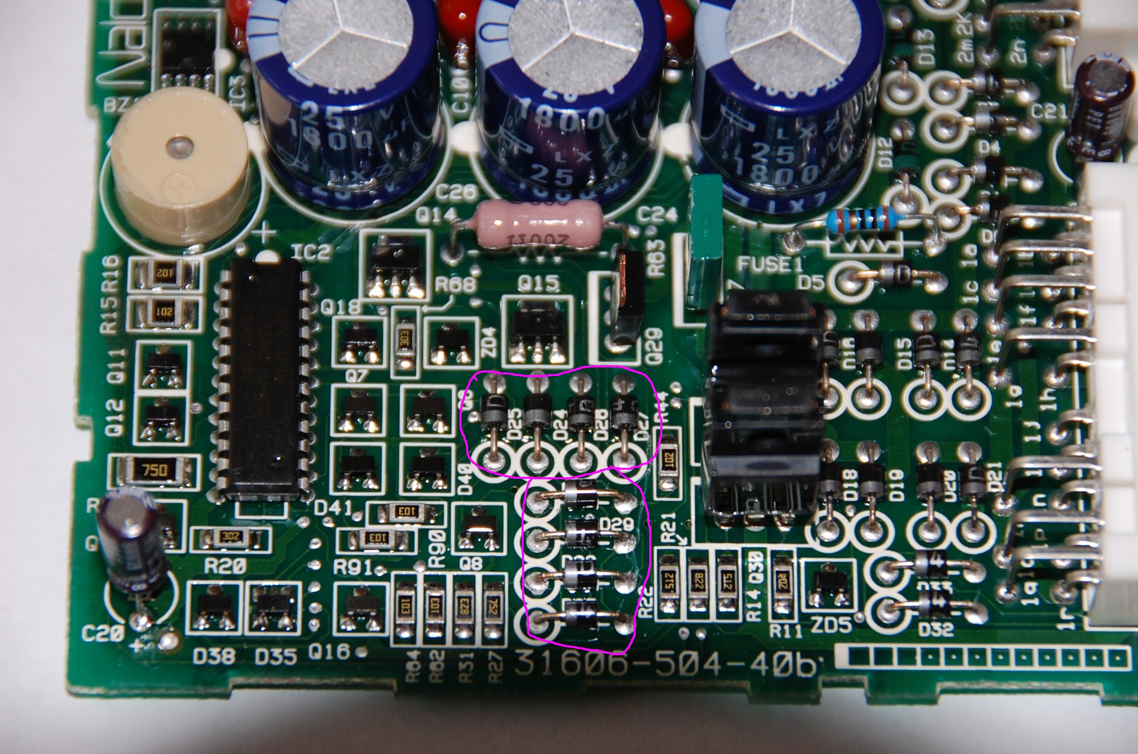

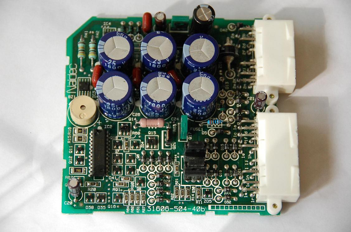

Can someone help me in finding replacement components for a 16-year old automotive (Mazda) diagnostic module ?
Diodes:
Using my Fluke 79 DMM set to the "diode" mode, all of the circled diodes are testing "open" in both directions, which supposedly means ALL of these diodes are "open" and need to be replaced.
The only markings I see are a "D" or "O" and a "4" (see attached pics for details).
Transistors:
NEC J143
NEC B1151
K105
Thanks,
:) neil
BTW: input voltages are only 14.2-VDC, electrolytic caps are rated at 25-VDC, and have been replaced.

Do you know what those diodes do? It seems more than a little unusual that you'd lose 8 diodes like that. Have you tested the transistors to see if they need replacing or at least if they fail a diode test as well?

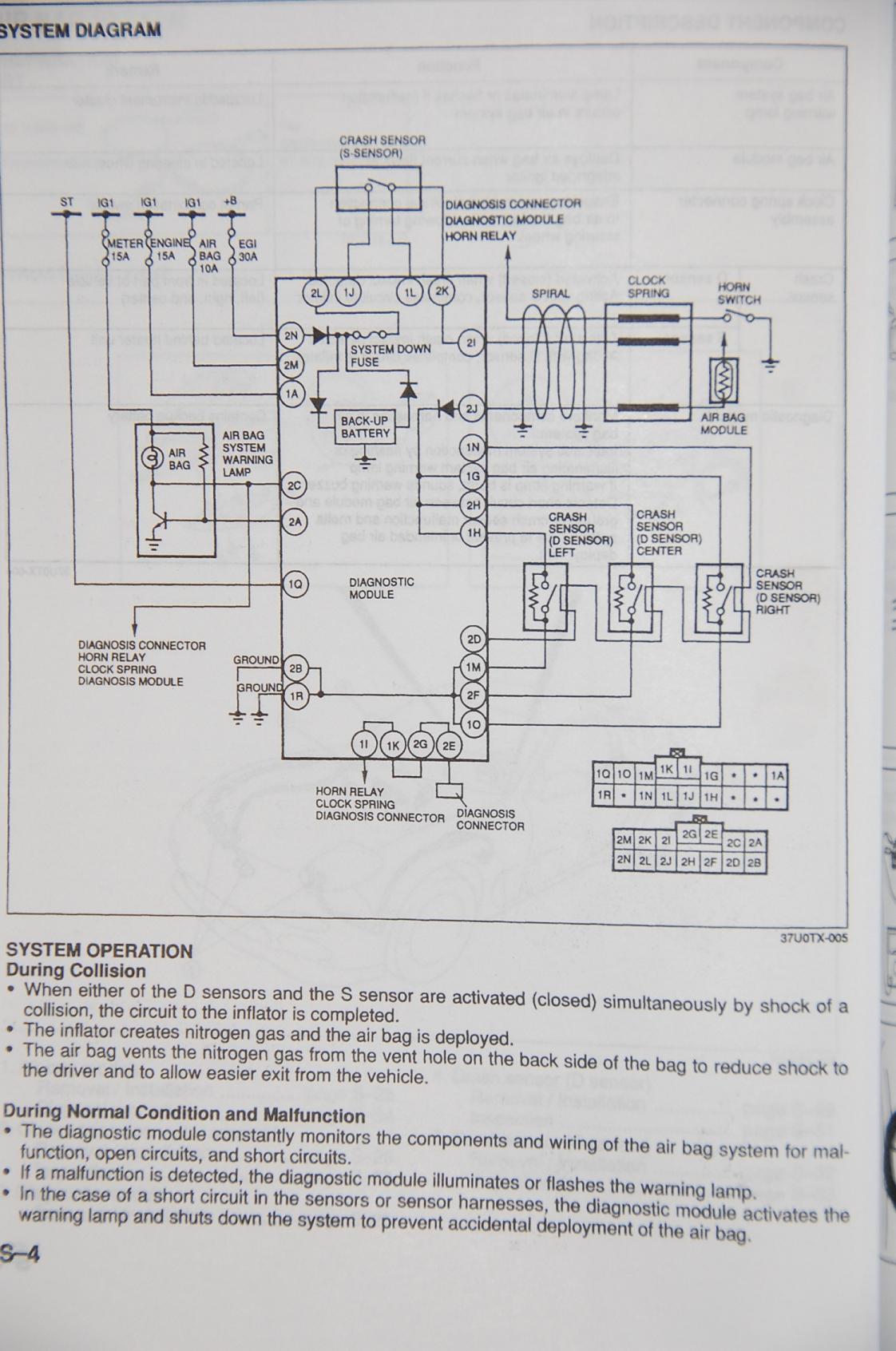

The diagnostic module is an airbag diagnostic module and is used to "fire" the airbag.
I have no schematic, and it seems ALL of the same diodes test "open" in both directions.
Attached is a narrative of the function of the module.
The module gives me a "3-blink" error, which means there's something wrong in the power-supply to the diagnostic module.
The flow-chart says to test all voltage inputs into the module. If they pass, then there's something wrong with the powersupply INSIDE the diagnostic module.
From the transistor id numbers, this is high-current transistor (NEC J153).
I'm thinking the transistors wend bad, and then they took out the diodes.
I am de-soldering one of the NEC J153 transistors, as both are testing open, to test out of circuit.
What do you think ?
:) neil

I seriously doubt all those diodes are bad, which makes me think they are all OK. Remove one and test it out of circuit, I bet it tests fine then (assuming your meter is OK).

I double-checked how to use the "diode check" on the Fluke79, and I didn't put it in the right mode (hold down 2-seconds, not 1).
All silver-banded diodes test OK.
Two green-banded diodes failed. Their marking are"D4" or "4D". Any suggestions for these replacements ?

I circled the bad transistor & diodes.
Need help finding equivalents.
:) neil
The transistors indicated are mosfets and do not check like a regular transistor.
source to drain will read open until triggered by the gate at which point they will go short(a few ohms) depending on the gate voltage.
In what way are they failed.
What is the resistance from resistance mode in both directions of the dud parts?
What are the readings in diode test both directions?
I lost one of the diodes.
Any idea on what replace them with ?
I could take one off the board, but there are no definitive identifying marks.
What measurements could I take and then make an educated guess ?
