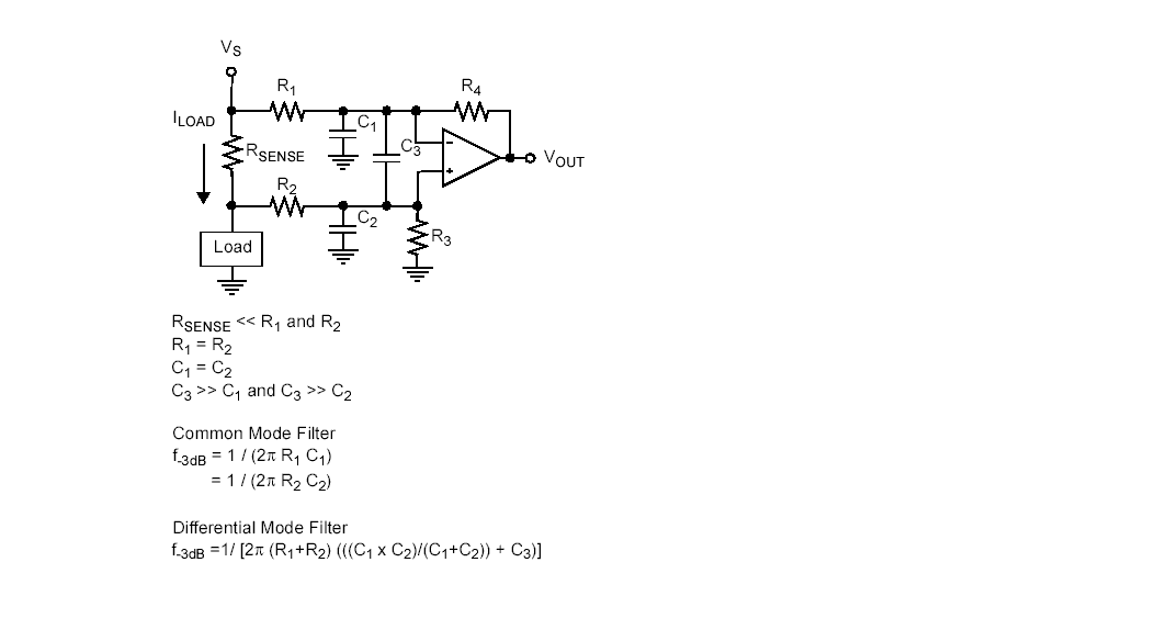

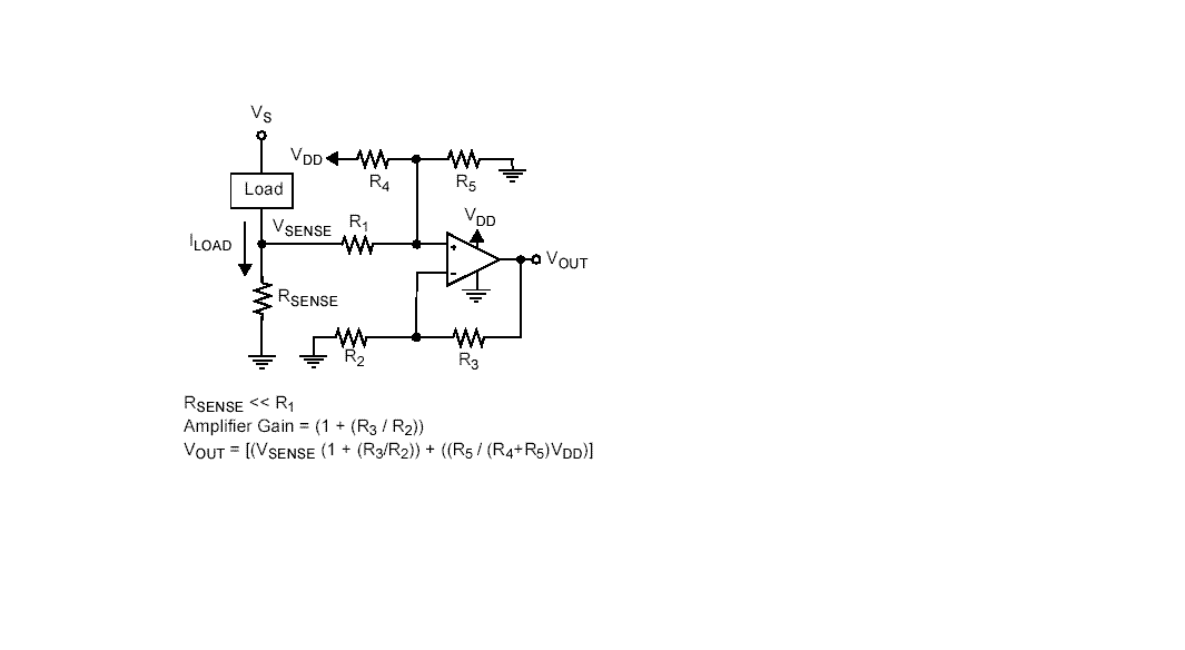

Can anyone help me, what is the approximate value of the components in the circuit1? I need approximate value for Rsense, R1, R2, R3, R4, C1, C2, and C3.And for circuit2, the value for Rsense, R1, R2, R3, R4, and R5. Anyone know? Thanks.
