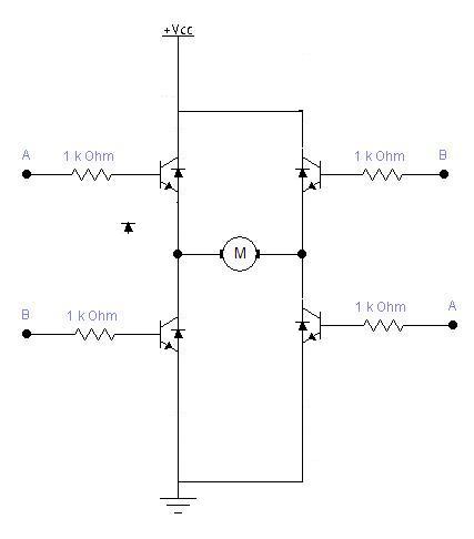

If your motor draws less than 1A, you could use just a NPN transistor, like a 2N2222. If you need to drive it in both directions, look for H-Bridge circuits. Here's the one I'm using to automatically open/close my blinds :D
The diodes are there so the back-emf from the motor can flow happily to 5V, instead of killing my AVR. The are called 'fly-back diodes'. :D
I only had NPN around, so its a lil different from standard h-bridges...

Well I've ran my h-bridge circuit off of 5 volts. There just common 2n2222 transistors. Since the electricity has to go through two transistors, the voltage is dropped to the motor by about 1.4 volts. (Each diode drops about 0.7 volts). What that means is when powered with 5 volts, my circuit will give the motor ~3.6 volts.
Honestly, that should be fine for your motor. If you wanted exactly 3 volts, just add an extra diode to drop it another 0.7 volts...

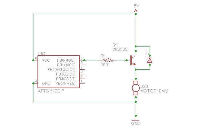

Hello Birdman Adam. Thanks for the post. That circuit looks a little complicated for me. Surely, since I just want to turn the circuit on or off I can use a single transistor? If I powered the motor by a single AA battery could I have a transistor single receive an ON signal (5V) and enable the fan?
I found the full details of the fan while trying to work this out.
Operating voltage: 1.5 to 3V
No load speed: 9,100 rpm
No load current: 200mA
Speed at max efficiency: 6,990 rpm
Current at max efficiency: 660mA
O yes! A single transistor will work just fine for turning the motor on and off in one direction. Since your current is 660mA, you have lots of options for transistors... I would just use a common 2N2222.
Here's a schematic that should work. The chip is just an example of a micro-controller input. Any MCU could be used to turn on the transistor. I have calculated the base resistor to be around 200Ω. The diode is there to allow the back-emf from the motor to flow happily back to 5V, instead of killing your transistor or MCU. :)
