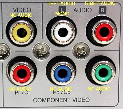

hi S,
Composite is only a video signal, no audio.
As Carl says there is ONLY L and R for stereo audio and the LEFT for mono

Look at this image.

next to the yellow video connector are the audio jacks (red and white) on my TV
and next to the 3 component video jacks are another 2 audio connectors (again, red and white) on my TV
i used the yellow for video and the 2 audio jacks next to the 3 component video jacks but i didn't get any audio along with the video (yellow)

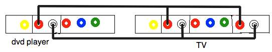

i want to be able to use the red and white video connectors for composite or component video on the tv and vice versa
Sources generally share one set of audio outputs between composite and component as Eric's picture shows, but a TV has separate audio inputs since the composite and component may come from different sources. If you want to share the audio between the two inputs you can use two RCA splitters such as this, one for each channel.
On the first splitter, plug each of the RCA male splitter plugs into each of the Red audio inputs for composite and component on the TV. Plug the RCA output cable from the Red source into the splitter RCA female socket.
On the second splitter, plug each of the RCA male splitter plugs into each of the White audio inputs for composite and component on the TV. Plug the RCA output cable from the White source into the splitter RCA female socket.

hmmm ,could you draw a diagram
i dont get what you mean when you say plug the RCA output cable from the Red source into the splitter RCA female socket. they is red and white female connections on each Y splitter and i don't know what colour the male splitter end is
Please pay attention. You are confused because you are describing a splitter with two female connectors and one male connector, which is not the one I referenced. That type of splitter will not work for your requirements. If you notice, my link for a splitter cable does not show any reference colors, and it has two male outputs and one female input. That is the type you need.
Simply connect all the red inputs and outputs together with one splitter, and all the white inputs and outputs together using the other splitter. It's not complicated.
ok done that so where do the other ends of the splitters go to
What other ends? On each splitter, two go to the two on the TV and the third goes to the source.
the ends left over on the black lines are the male connector
the brown line is for the vice versa

I guess a picture is indeed worth a thousand words. Here's the hookup. Two connections for each Y connector to the TV and the other to the DVD player.
Now was that so hard?
OACH! i get it now, i got mixed up and thaought the loose ends were for the dvd player when they should have been connected

What? If you connect it like the diagram (all reds connected together and all whites connected together) you will get stereo for either composite or component to the TV. Don't understand what you mean by swapping connectors over.
(if you swap the 2 ends over you would get composite and component stereo playing at the same time but thats a different story)
the thing is, will i get the audio next to the composite video jacks but playing along side the displayed component video?
and vice versa
The connections I show will give you stereo sound from the DVD player if you select either the composite or component input on the TV. The TV will not allow both composite and component be on at the same time so your comment about them "playing at the same time" makes no sense.
The signal doesn't care and is not affected by the order of the connection, so I don't understand you comment about "swap the 2 ends".
