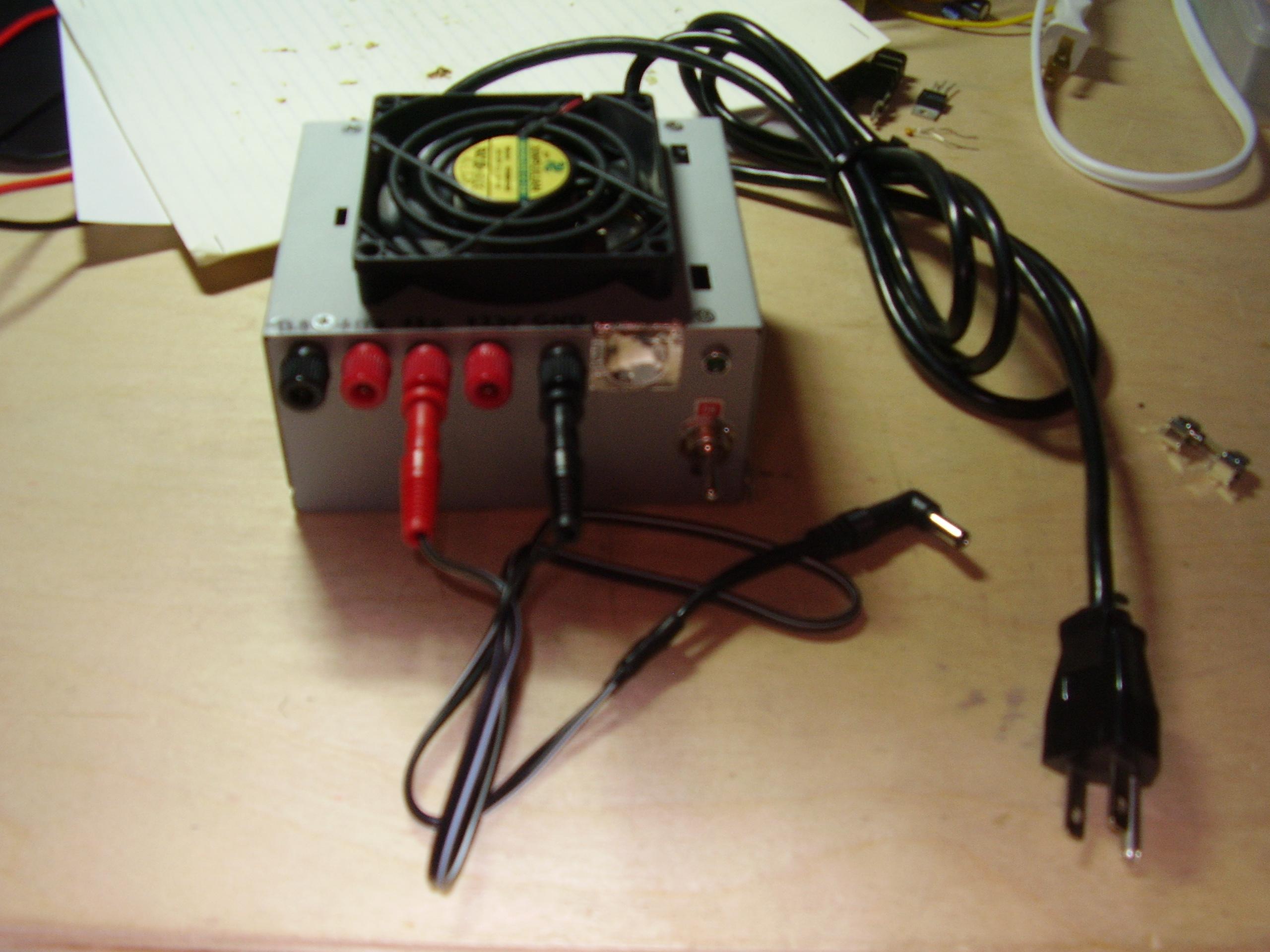

Here is the PSU I made:
Weird, it looks just like mine! ;)
