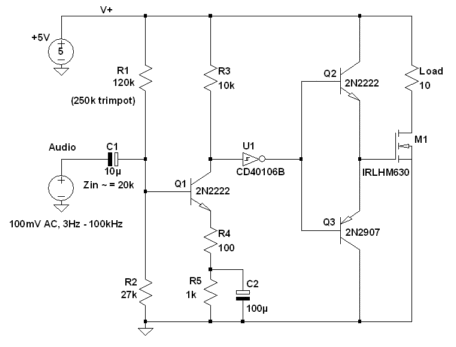

You already seem to have covered most options! Regarding the analogue audio output, that can easily be converted into logic-level signals suitable for driving FETs.
Here's a circuit which will convert an audio signal (100mV amplitude or greater, 3Hz to 20kHz) from the PC into a logic-level signal and drive a FET ...

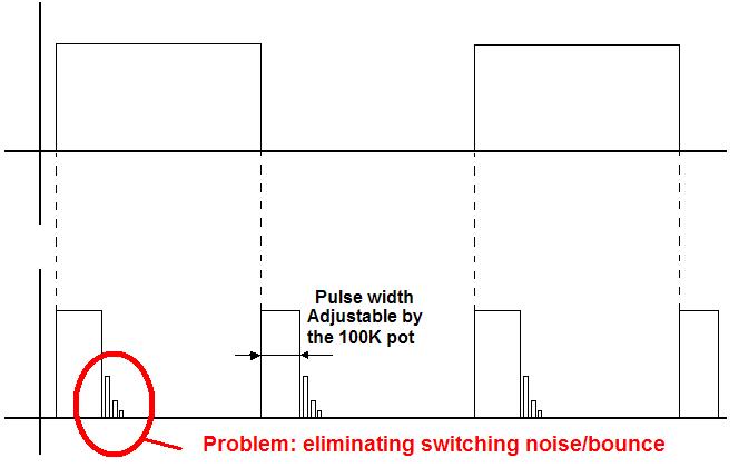

It seem to have some switching noise. How do I "de-bounce"/"clean" the fake switching after an audio raising/falling edge? :confused:

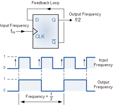

I have noticed the 100k pot at the entry in the circuit, and the higher I go with the switching frequency the lower I have to adjust it. If I have a wav file with a square wave sweep from 10Hz to 500Hz, I will have to manually adjust it with the raising frequency. I don't like that. I thought about another solution regarding this. I could place the output of this circuit through a divide by 2 D latch: :eek:
Now my input signal sent by the computer will be identical with the one seen at the output. Therefore, if this will be the case, then the 100K pot should be replaced with a lowest value acceptable. (I don't know how to calculate it but I know that we have to account for the working frequency band 1Hz-20KHz), so that with each raising and falling edge of the input pulse will be a one-shot with the pulse width slightly grater than the minimum seen by the latch. However the cleaning/de-bouncing the switching noise still presents as a problem :confused:. I think a some kind of threshold voltage level condition should be place, but where in the circuit or how, I don't know . A filter at the input? :confused: But won't that effect the working at higher frequencies? :confused:I don't know. How do we solve this? Please, I'm begging you, help…
1) At which point in the circuit are you detecting the 'switching noise'?
2) What is the amplitude of your input signal?
3) That noise looks to me like ringing due to stray inductance. Have you built the circuit on a breadboard? Are all wires very short? Is the 'scope cable screened?
It is for setting the bias so that Q1 collector is at half the supply voltage. If the bias is not correctly set then asymmetric clipping of the waveform may occur and only half of the wave may switch the FET.
The mid-rail setting point should be independent of frequency. It's possible the amplifier (Q1) gain is dropping off at higher frequencies. Try by-passing C2 with a 100n cap.

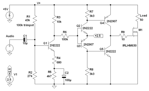

I've designed a modified circuit to provide cleaner pulse edges, by using a CMOS Schmitt trigger, i.e. involving defined thresholds as you mention.

1. At the output, directly visible on a light bulb, at ELF.
2. I don't know, I didn't measure it. (it turns out that this was the cause)
3. It's build on a breadboard. I try not to use wires at all. Connections are made using staples. I didn't use a scope.

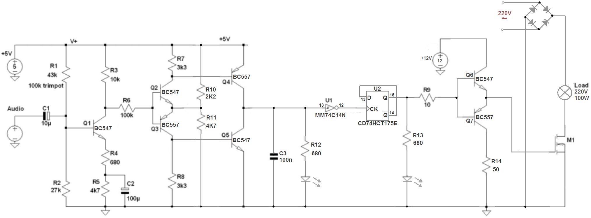

After so many hours of failures, I finally made it to work, in a kind of hybrid "tweaked" state.
If you have seen what I have done to your circuit, I say> Please! Don't laugh! Have mercy! I'm a beginner! :eek: Show some understanding…:eek: please….I have no idea what I have done, but fortunately it works…I messed up everything, I know…mercy…I thrown in new components in hope it will work. I was lucky :eek:…Forgive me…That's not how electronics must be done, I know. But for better or worse, it works. :D
I have to admit, I hate analog processing. I just hate it. :mad: Too many things can go wrong. That's why I am extremely fond to digital electronics.You only have 1 or 0. Either works, either it doesn't. Simple. Nothing in between. ;) That's why I'm not very comfortable having this circuit drive my power mosfet directly. I'm more relaxed knowing that it's pure, clean, digital signal that is driving my FET. That is why I've changed the circuit. Instead of 2.5V in between the complementary transistors I used 3.3V. The reason why is because, It was readily available in my custom made altered CPU PSU power supply. So I just hook that voltage there. Probably it messed the circuit and your design, but I don't know. I managed to adjust it the way it is. I've replaced the 3.3V pin with a voltage divider. It seems not to work anymore when I put 2.5V there the way it was supposed to be, it only works now with 3.3 because of my adjustments.
I kind of understand how the circuit works, but not completely because the output on the gate of the FET in your original design, when I've test it, seems not to have the same PULSE WIDTH as the one generated by the computer.
This is why I hate analog processing of signal. :mad: So I took the generated pulses and put them through a D-type Flip/Flop so that, again, like I said, either is one or zero. Voltage level or Zero. Works or it doesn't. So know those short pulses (generated at the raising and falling edge of my original pulse in the computer) will be reconstructed.
Before the Schmitt trigger I used a capacitor C3 that seem to help in the ELF band between 0.0001Hz and 10 Hz. (0.0001 Hz means one pulse at every 2.7 hours). Probably you will go nuts, hearing that I'm stressing you design to switch on so low frequencies, especially when you design it from 3Hz upwards, but I don't see the harm. Strange enough it seem that this capacitor sometimes it's not required. Maybe something on my custom-made breadboard doesn't make a firm contact or something. I don't know. I will see when I move the circuit on a board.
Another very important aspect of your design, that I didn't figured out at first, was that it requires a "narrow band" for the input voltage. I didn't measure the input voltage in the circuit, but my master volume from windows is set at 14%. If I set it to 17% it starts to "jitter" if I can use that term, and bounce, and all that noise, and distortion after a falling edge from a pulse. So it took some time before I realized that. And is more likely to happen on low frequency. Above 500Hz it works well even without any additions. :)
With all these modifications, it seems that changing the R1 100K trimpot has no effect on the operation of the circuit whatsoever. Now the only adjustment that has a major impact on the working of the circuit seem to be the input voltage coming from the soundcard. The master volume in XP is set at 14%.

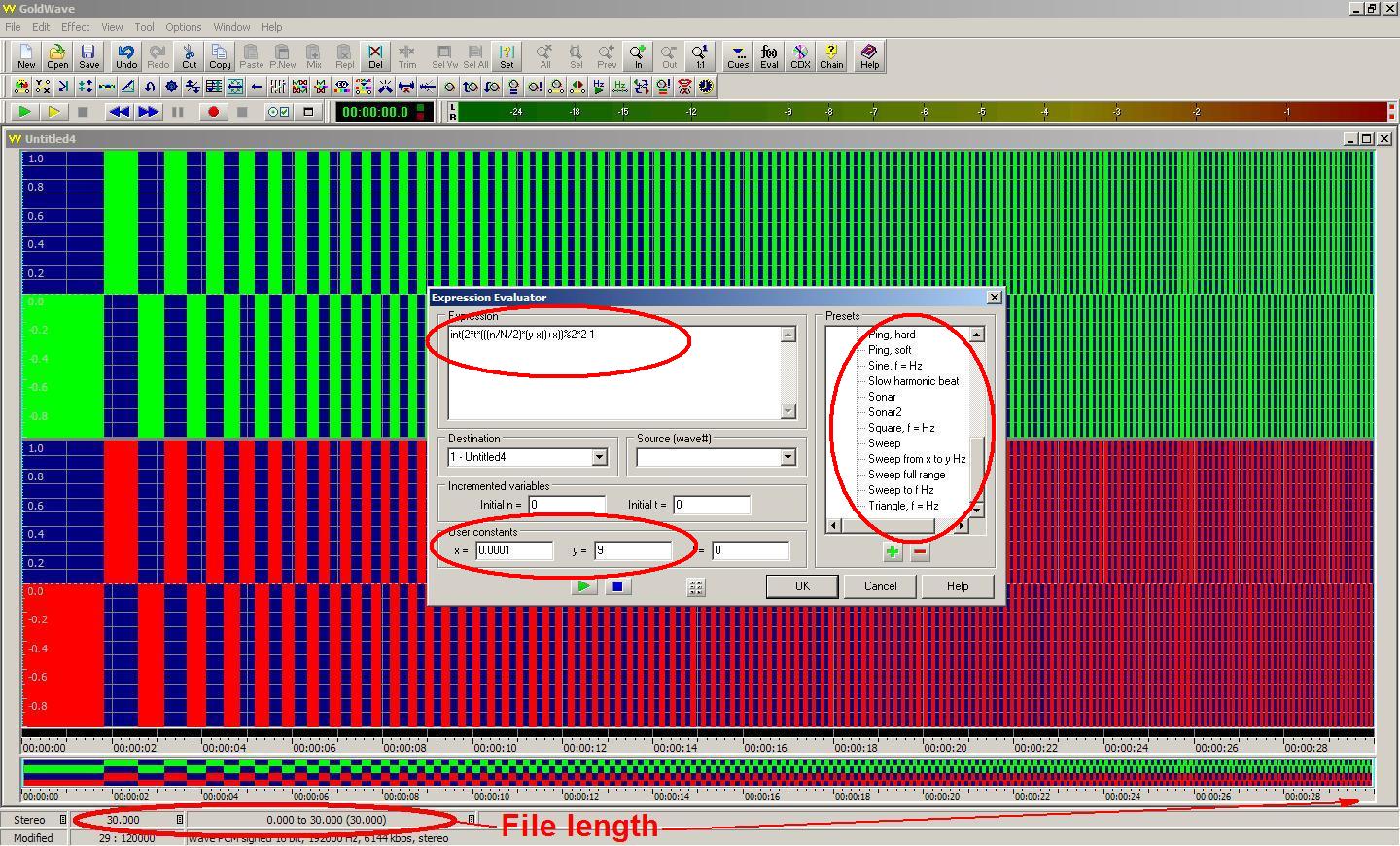

Regarding the answer Mr RB to my problem, I will reply to him and to those ho later on, read this post. I'm not after that. :( I know that probably the title of the thread doesn't accurately describe my real problem. I know, I know. There are hundreds of applications/software's that can put out square waves at the soundcard output and many other signals. I'm not after that. I know that. I want something else. Which is not obvious if one reads only the title of the thread. Ultimately, for example, I want to light a 220V 100W light bulb with positive pulse wave at 535.2 Hz from the audio output of my soundcard! Or I will want to drive a 20A current through a 4ohm coil at 1206.3456Hz using the audio output from the computer and a special software that has the ability of generating such signals with such a high accuracy frequency! :p Many software's specialized in signal generating from the soundcard, are unable to do that. Mostly can only generate an integer number as the frequency. Again, I don't want that! I want high accuracy with easy and cheap materials thus high accessibly! :eek:
Maybe this circuit won't have the frequency stability that I need, like say if I put out a consistent 45.5421 Hz it will fluctuate with +/- 0.001 Hz or higher. Ok, Ok, I accept that. It's acceptable. As long as such a method of generating the computer controlled positive pulse wave from the audio output is much more precise than your steady/rock hand on the potentiometer of your common signal generator, I'm ok with that. If it's slightly more precise/accurate that the common ordinary signal generator, I will take it.
I'm using GoldWave as the source signal, and has an extremely useful ability to generate any type of signals, with the "Expression Evaluator" tool. If you have a power amplifier it's even better! Of course the load impedance must be adjusted accordingly to have the required output power. Goldwave It's able to analyze/calculate/evaluate any mathematical function you input, and gives you the result of the function versus time as a wave. It can work with frequencies up to 0.0001 accuracy. Can also sweep a signal from x to y, Thus I can automatically program the computer to sweep from 0.0001 Hz to 5Hz in a one hour length wav file!!! (a lot of HDD space) This will AUTOMATICALLY advance the frequency by 0.0014 Hz with each passing second!!! And I don't have to turn a single knob!!! ISN'T THAT COOL OR WHAT? :D Show me another easy/accessible/cheap way of doing that!!! There is none!!!
