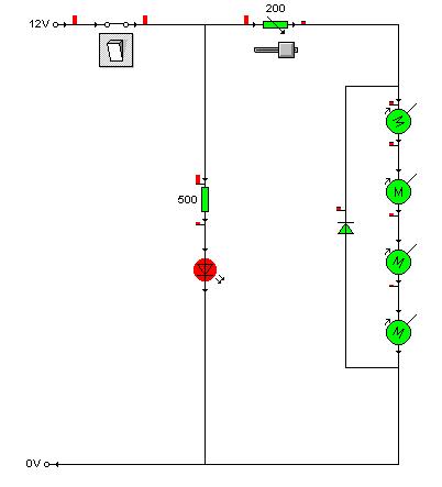

Ive got hold of a copy of crocodile clips, and Ive put together a simple circuit. Take a look at the attachment and tell me if it would be suitable.
Basically I would like to have the option to reduce the speed of the fans rather than having them blasting away all the time. Are the values OK or could it result in damage occuring? When the variable resistor is at 200 ohms it says the motors are spinning at 1293 rpm and when its at 0 ohms it says there spinning at 4593 rpm. I know the motors I will use wont be anything like this but is that design alright?

The motors will have to be in parrallel for a start, because each one requires a PD of 12V in your circuit they will only have a PD of 3v each - possibly not enough to kick-start them! Also bear in mind the motors will have to have a minimum speed to prevent them from stalling and the variable resistor will not drive that load without overheating - you will need to drive with a transistor or fet.
Do you think you could draw out a rough diagram of how the circuit would look? How would I drive it with a transistor? Im useless when it comes to designing circuits :oops: .
Thanks,
Lizo.
Sorry bud I have been out all night and ready for bed now but will try to do somthing for tomorrow :)
