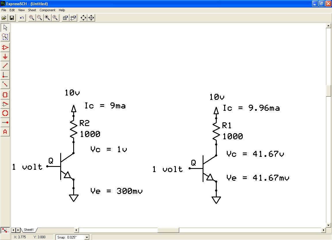

Tina vers transistor sim
here are two of the same circuits but slightly different results.
what are we supposed to look for for a good reliable circuit?
when using a spec sheet how does opne determine saturation, base current .
I know most transistors require .7 volts to the base but what resistance to use to figure out the base current? .7volts divided by ??=current at the base to achieve saturation.

You are forcing a base voltage with unlimited current instead of applying a base current through a current-limiting resistor.
how does one compute how much voltage and current to drive a transistor into saturation?
Most datasheets show the max saturation voltage loss when the base current is 1/10th the collector current.
if using a simulation program what would be the worst case so circuit at least has a good chance of working??
A sim program works with "typical" specs, not worst case spec's.
Some parts (typical and better) will work but low spec parts probably will not work.
