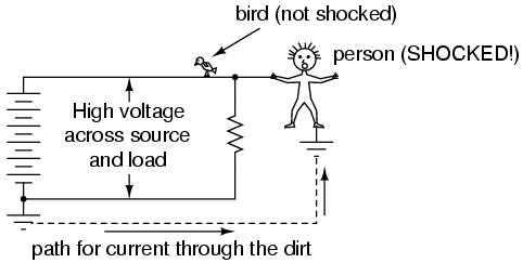

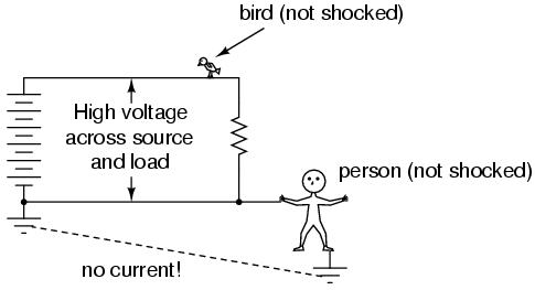

Hello, newbie here with newbie question:
Why is the man in the 1st picture shocked while in the 2nd he is not? I'm assuming the current is traveling counter-clockwise so the only difference between the two pictures is that the man is standing either before or after the resistor. Why does his position in the circuit matter in regards to getting shocked?

Your diagram already explains it perfectly, in the second case the man is connected across the supply - so he gets a shock. In the first case he isn't connected across the supply, so he can't get a shock.
Try getting a battery and a small bulb!.
Connect the leads from the bulb to each end of the battery, the bulb lights up - picture 2.
Now connect both wires from the bulb to the SAME end of the battery, the bulb doesn't light - picture 1.
Exactly the same as your diagram.
THis looks right to me. In the first pic, the guy is forming a short from Ground to Ground...no danger there. In the second pic though, he is forming a short from Possitive to Ground bypassing the resistance and creating a human lightbulb. The bird is not grounded, therefor it is ok.
~Mike
Edit: Damn, late again :lol:
The voltage is across the resistor. The bottom of the resistor is connected to ground - the man is connected to ground = no potential (voltage) difference.
The top of the resistor is connected to the high voltage side of the power source. The man is still connected to ground. Voltage across man = lots. = dead man.
The bird on the other hand is not connected to ground and so can happily wander around on the high potential wires.
HTH
Edit: damb even later.
