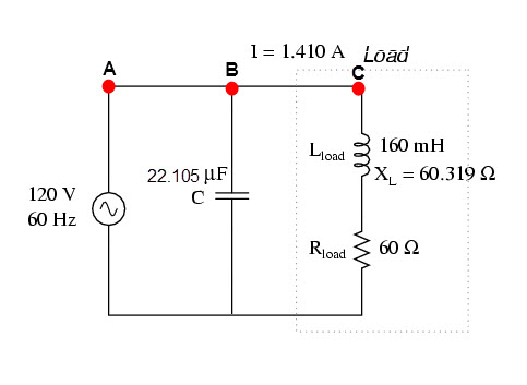

Thanks a lot for helping me with the queries, Ratch.
No, you calculated in the next question that a PF of one would make the circuit look like a 120 ohm resistor.
Now I look at it again carefully, I feel that I don't really understand it.
This is the calculation which was made. We have a 60.319Ω inductor and 60Ω resistor in series and it gives total series resistance of 120.319Ω. As was calculated the current supplied by AC source is almost 1A and 0.410A is supplied by the capacitor. This is how I was thinking previously. I was under the impression that inductor is totally 'powered up' by the capacitor and the AC source is only concerned about supplying power to the resistive load. In other words, I was treating the interaction of capacitor and inductor in a way as if they are really absent from the supply's perspective and they both constitute an independent system of their own. But Ohm's law fails, i.e. 1^2*60 (power dropped across load)120*1 (power generated by supply), where "60" is resistance of load, "1" is current supplied by the source and "120" is RMS voltage of the supply. Total power generated by the source is 120W but only 60W is dropped across the resistor which means the remaining 60W is dropped across the inductor. What are those 60W doing in the inductor?
Please also note that I do understand that overall resistance of the system is 120Ω as is calculated here in detail.
Where am I going wrong? Could you please guide me? Thanks

My poor little brain cannot follow the twists and turns of this thread, I must go back to basics.
A perfect resistor has resistance.
A perfect capacitor has reactance.
A perfect inductor has reactance.
When a component/circuit has resistance and either inductance or capacitance, or both, then that component/circuit has impedance.
Example:
If we have a series circuit, with a 30 Ohm resistor and a capacitor with a reactance of 40 Ohm at the frequency we are interested in, then the impedance will be:
Z = Sqrt(30^2 + 40^2) = 50 Ohms.
If we have 100 volts across this series circuit, the current will be 2 Amps.
The voltage across the resistor will be 60 volts, and across the capcitor 80 volts.
Does this start to clear your confusion?
Continuing the example.
If we re-connect the R and C, so that they are in parallel, and we put this same 100v supply across them,
The current in the resistor will be 100/30 = 3.333 Amps. That current is in phase with the supply voltage.
The current in the capacitor will be 100/40 = 2.5 Amps. That current is leading the supply voltage by 90 degrees.

You had 1.41 amps existing in both the inductor and resistor which was supplied by the power supply. Adding a capacitor did not change any components in the L-R branch, and the voltage was not changed across this branch. Therefore, the current existing in the L-R branch after the capacitor was added remained at 1.41 amps. Afterwards, however, the energy in the L and C swap with each other twice every cycle, and the power supply only needs to supply 1 amp. In other words, the PS only has to supply the losses from the resistor.
Ratch

Mathematically, I understand it but conceptually I'm somewhat confused.
The 120V supply is supplying 1A which means it's outputting 120W. The power dissipated by resistive load is also 120W because the current passing thru it is 1.41A.
The current supplied by power supply is 1A but the current passing thru load is 1.41A. Where does extra 0.41A come from? I believe that it comes as a result of power/energy swap between L and C because this power/energy has to travel thru the load and power is product of voltage and current. The voltage being dropped across load is 84.6V. I'm having difficulty visualizing how all this is taking place. Could you please guide me? I have also attached Multisim13 circuit. Thanks.
Regards
PG

You have to see the entire circuit as a system. Looking at one component or value works in a static world but as soon as you start to look at dynamic or changing energy flow it doesn't as all parts depend on each other. The problem IMO is how electricity is taught in the beginning that tends to build a narrow mental image of circuits. You need to look at energy flows in circuits not just as voltages and currents but as fields in motion around the components in your mind if you want to visualize circuits.
This won't answer your problem of visualizing "how all this is taking place" quickly but it might in the long run.
Regards
PG
One amp of current comes from the power supply, and 0.41 amps comes from one of the plates of the energized capacitor. Together they supply 1.4 amps to the L-R branch. The opposite plate of the capacitor receives 0.41 amps with the remaining 1.0 amp returning to the power supply.
