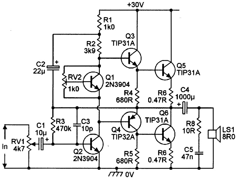

Hi, I designed a simple B-Amplifier.
Output power across load= 3.91W
Power delivered
by +15V DC = 6.35W
Power delivered
by -15V DC = -6.35W
How should i calculate efficiency ?
Add both input Powers in formula ? or just use one ?
i.e.
Output/ Input power = (3.91Wx100)/6.35W or = 3.91Wx100/(6.35+6.35)W

Yes, it's total of both, if you measure each supply separately to 0V.
Your efficiency is around 31%, which is not too bad for a small class AB amp; then can never be high efficiency - often the 40% range for higher power ones.
[Digital amps - Class D etc. - can reach 90%+, but not conventional Class AB].

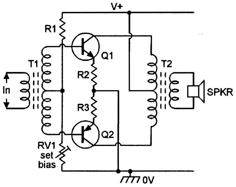

I tried it with transformer coupled B Amplifier. for same output power 3.91W.
Surprisingly, each DC output power fell to 4.58W.
Efficiency
according to 3.91Wx100/(4.58+4.58)W : 42.7 %
It got efficient ? or Why is that so ?

As you have it in the diagram, there is a 1.2V "dead" range between one transistor turning off and the other turning on. With no bias at all, each transistor is technically in Class C, as it's conduction is less than 180'
Class B would have a clean changeover between conduction of the two transistors, but without any overlap.
The higher amplifier class you go to, the more efficient, though less linear (more waveform distortion). That does not matter in some applications, but it's pretty important for audio.
See the article here:

adding transformer coupling
... With no bias, has changed it to a class C push-pull amp; think of it as being half way towards switch-mode; it's no longer linear or suitabel for audio as the output distortion would be terrible.
It's nothing to do with the transformers, it's the change in (or lack of) bias in that setup.

Try emulating the adjustable bias circuit in this design - T1 and the preset potentiometer.
That allows the voltage between the two bases to be adjusted; for class B it should be as near the point the transistors conduct as possible, without them taking any standing current.
Or this style, for the transformer coupled version - again, set it just below the point there is standing current for class B.
Note that a properly biassed class B amp has some crossover distortion, but not "very distorted" - that's what the zero bias one would be.
