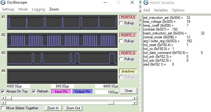

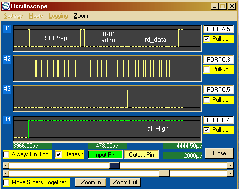

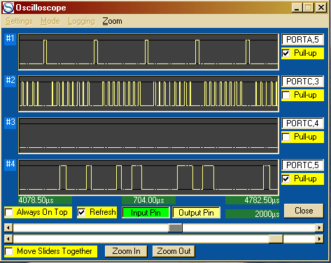

If you check your scope image it appears that every other block of clock pulses is carrying no data.??

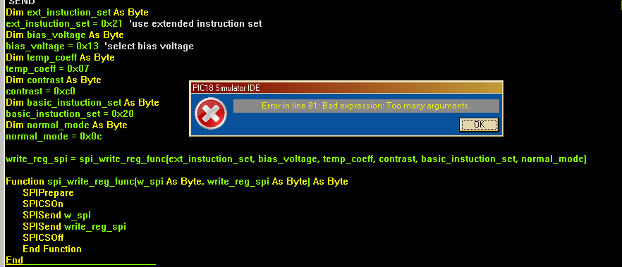

The SPIPrepare should be part of the main code, not be within the Proc.
Try it.

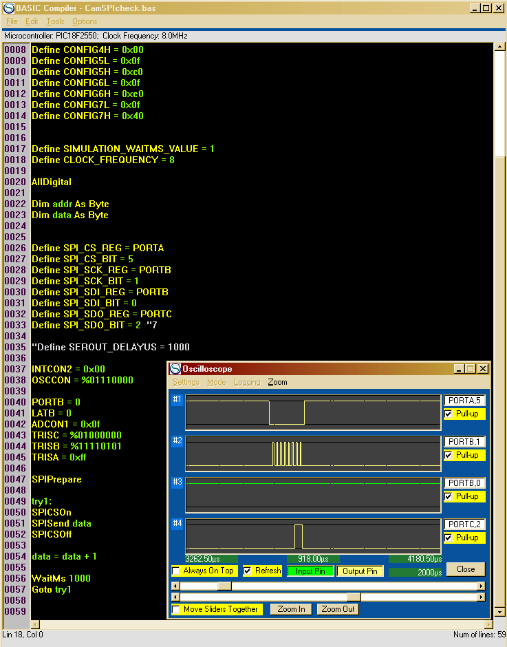

Hi,hi,

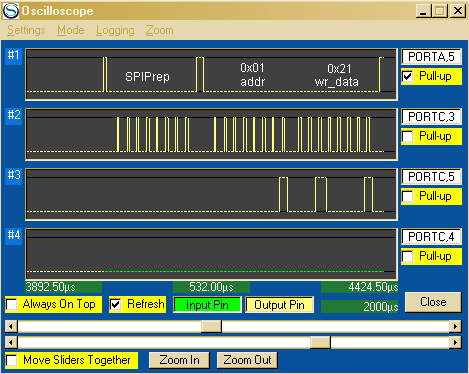

I have run your post #7 program, I get nothing like the scope image you have posted.??
E
Hi,hi,
Yes
E
Hi E,hi.
I read the PIC type as 18F2550 not 18F2520... woops.!!!
I quick try shows a better reult
Will try again in detail after lunch.
