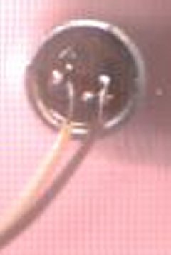

Here is a scan of the mic currently in the phone. As you can see it has two wires. How to i convert this for connection to my electrec mic headset as we discussed earlier. Also, can i use a 78L05 to power the electrec mic from the phone line. If i can do this, how do i do this?
hmm, the two wires connected to the mic in the picture will be ground and signal. err, not sure how you find out which is which - maybe someone else knows?. (see if you can look at the circuit board, and work out which wire is connected to ground).

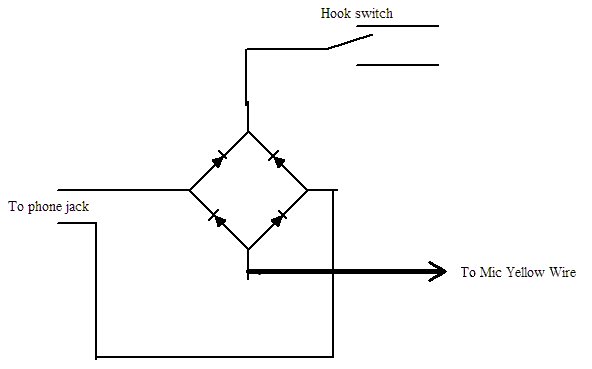

As for the mic connections, i've traced back the pcb and drawn this little diagram below. Based on the fact that the yellow is connected to the negative side of the bridge rectifier (4 diodes on pcb) i would think that that is the ground. What do u think?
yep, I agree.

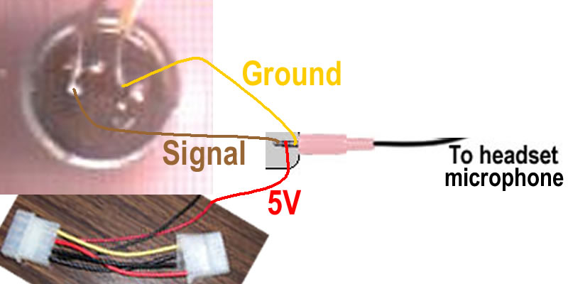

Well think about this for a just a sec. This is gonna be on my desk (as it's for use when at computer) therefore i was thinking... what if i connected the 5V terminal of the mic socket (the "ring" in the diagram) to the red wire (Red=5V, Yel=12V, Black=GND) of one of the drive power connecters in my pc. I have a ton of spare computer psu cabling so i could probably rig something up. What do u think?
worth a try, and it should probably work. although to start with i'd put a resistor in series, just in case. You can prob take them out when ur satisfied that it works.
my only other suggestion is that you use the power from the mic socket (just leave the ground and signal unconnected). Ur sound card may get a bit confused but hey, never mind
either way, if your bios on ur comp has a voltage measuring thingy, i would check it to make sure that ur new wirring hasn't screwed it up (the voltages should be not more than about 0.5v out of where they should be)
I didnt mean the mic socket of the soundcard. I mean the mic socket of my project (that the headset plugs into) is connected to my pc psu 5v output. see diagram below...
