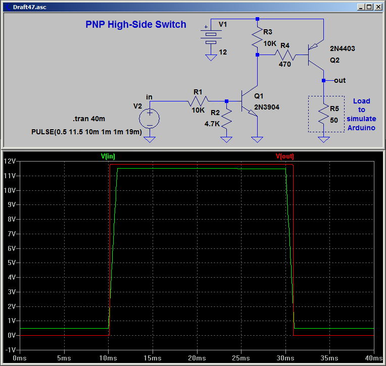

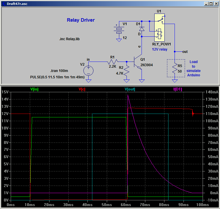

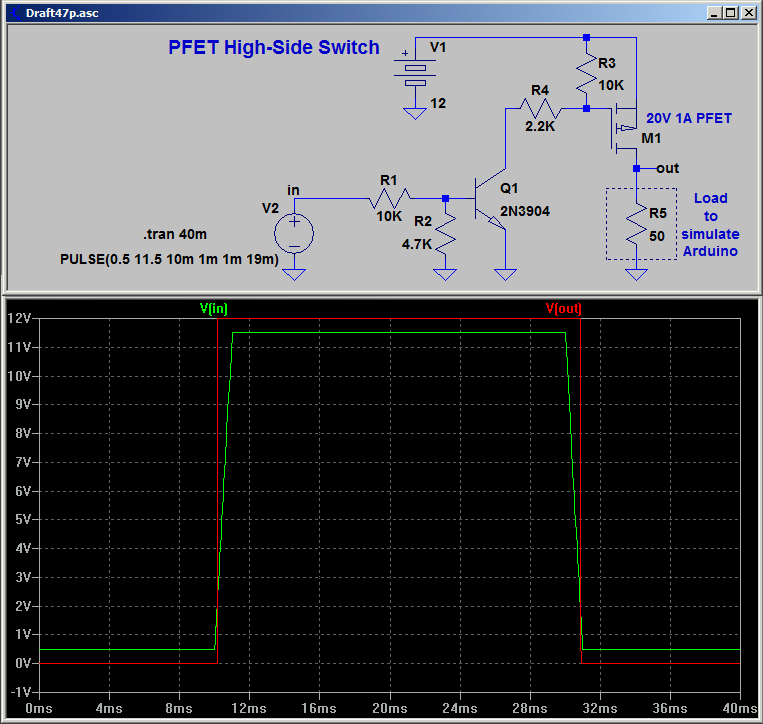

Hello, I need to connect arduino to my car and I need a little bit of help because I don't want to fry the stereo.
I have no remote wire because stereo is controlled via can bus and my lighter socket is always on, but I have electric antenna out on my stereo and I already have my amp connected to it and it works.
Now arduino can take up to 1A of current so this is a no go for antenna out.
Can I use e-antenna out for powering relay's coil so I can use a relay to turn arduino on and off?
And I have read somewhere that it is good idea to connect flyback diode to the coil to provent popping from speakers and risk to damage stereo because of voltage spikes? (I have seen them turned right way + to + and - to -, and some of them reversed, how I should turn it)?
How many current can electric antenna out provide?
Thank you for anwsers!

So your "e-antenna" signal may just be an output to power a remote-mounted antenna RF preamp, so might be good for driving only a few mA.
Here is what I would do: First choice: a high-side transistor switch using a NPN driving a PNP or PFET. Second choice, an NPN driving a small relay coil. I would not try to drive the relay coil directly as you show above.
View attachment 106338 View attachment 106339 View attachment 106340
Hy, thank you for schematics, I will go with second option. I also wrote an e-mail to blaupunk service and thay anwsered that they have no info about pin's output current.
