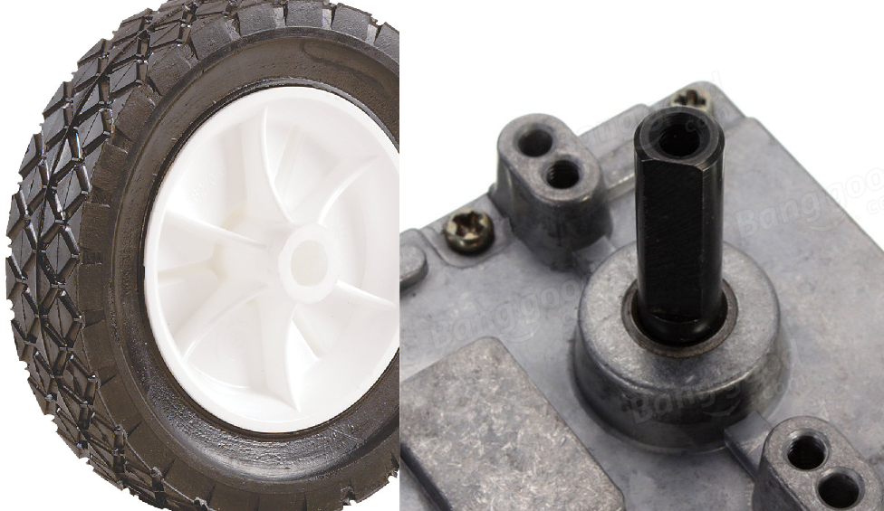

I'm looking for ideas on how I could connect the following wheel, to the motor shaft below? Ideally, I would like to connect it directly, without a belt.
Wheel : Bore size 13mm
Motor : 8mm shaft diam, 25mm shaft length, M4 thread.
Any ideas?

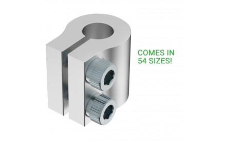

I have connected one of these to the motor shaft and then used 4 screws to connect to a wheel.

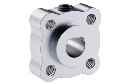

I have some that are 0.25 inch. They are used to extend the length of a radio volume knob.

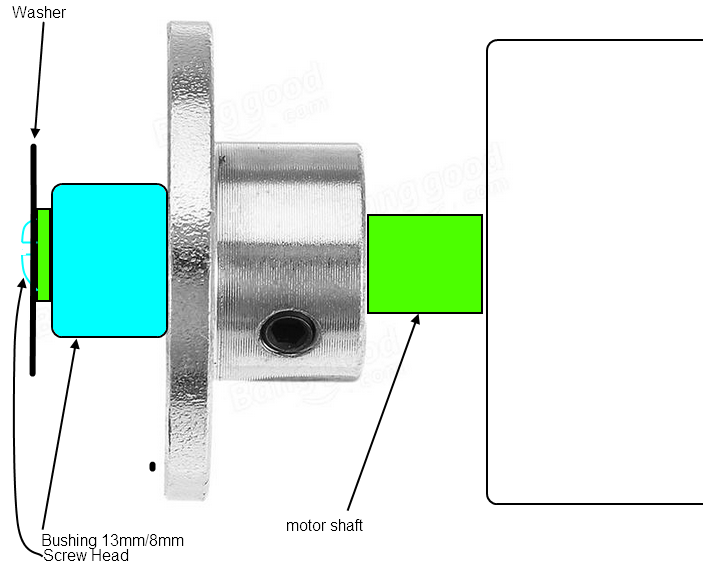

Expanding on post #14;
It looks like the motor shaft has a place for a screw on the end. Show in light blue.
I found bushing with 8/13mm size.
Using the item form Post #14.
The wheel, not shown, sits on the bushing and is pinched between the washer and the flange coupling part.

Unfortunately, there isn't enough meat to drill a 16mm hole, or to mount the flange. If you have a look a the image I posted, there is only about 2mm around the 13mm bore. Although I guess I could attach some kind of hubt
As to your questions. It doesn't need to be super accurate, as long it is running visibly true then that should be fine. It's running at a very low RPM (~60), so any vibration caused by run-out probably won't be noticeable. As for tools, I do have access to a drill press, but not a lathe.

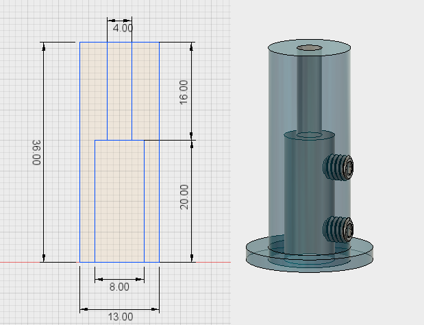

Going a little bit further with TCM's suggestion from post #2..
Unless there is going to be a lot of load on the wheel, this could be made with a drill press, but you would also need a washer welding on the end and a tap to make holes for set screws. I left the length at 36mm to allow for a washer with an ID of 13mm to be slid over and tack-welded in position.
The wheel would be sandwiched between the welded washer and another washer, secured with an M4 bolt going through to the motor shaft.
You could use set screws which protrude slightly and file a key-way into the wheel, to prevent the load on the wheel from unscrewing the M4 bolt, depending upon direction of course. If the motor turns clockwise when looking at the shaft end, this is something you will need to consider.
Drill 4mm and 8mm holes as shown, in a length of 13mm rod, drill & tap holes for the set-screws.
Measure the depth of the 13mm hole in the wheel and position the washer so that the shaft will be a couple of mm short of being flush with the outside of the wheel.
Weld the washer from the back and clean up as required.
Secure the bushing to the motor shaft, mount and secure the wheel with another washer and M4 bolt.
Just an idea, I hope you can use it for your application.
Regards.
Hmm. very good! .. but I would need to drill exacty on center for all that to line up! ... gonna do a little research to see how I can accuratly drill holes in rod section
