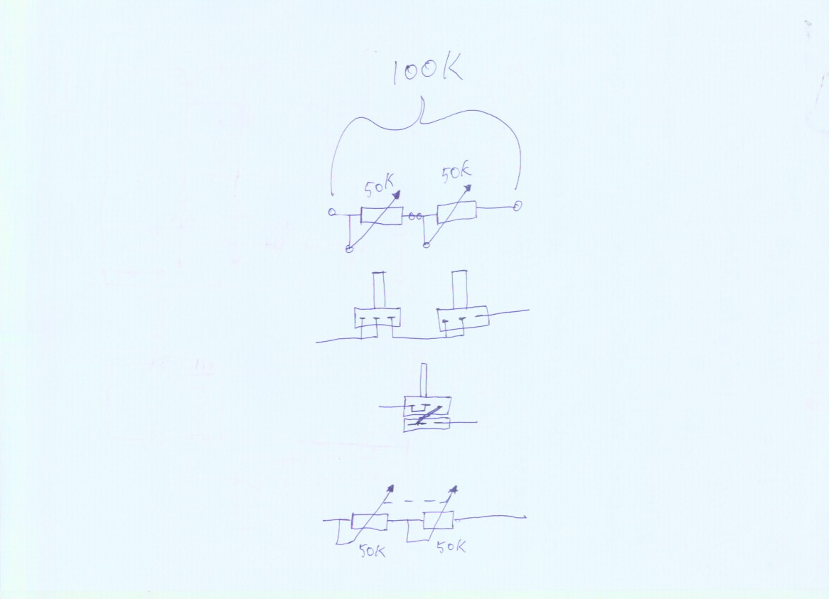

I have two 50k pots and I need a single 100k pot, is there a way that I can connect the two 50k's (possibly in series) to make them equivalent to a single 100k pot?
I have played around with these pots, and have been unsuccessful, any help will be appreciated.
If it is possible, will you please be as detailed as possible, I know little about electronics.

If you tell us what the pot is for or post a schematic then we can determine if a single 50k pot will replace the original 100k pot.
put them in series
is it a stereo pot in one housing and with one turn stick or 2 seperate pots ?

A small sketch will explane it

Thanks rjvh, I had a dual 50k (single shaft) pot, and your sketch was very helpful.
