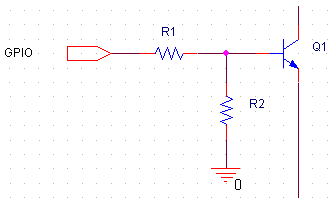

I was wondering why the below configuration is used?
Specifically, an engineer I met has used the following values:
R1 = 4.7KΩ, R2 = 47KΩ
I was wondering what R1 and R2 are for, and why R2 equals 10 times R1?
Thanks.

If we use BJT as a switch then we add R2 to create path to GND to avoid base from floating.
And sometimes the low level voltage is to high to ensure cut-off.
So we put R2 to proper cut-off the bjt.

And I forgot to mention that R2 increase switching off speed and also pulls-down bjt leakage currents, particularly at higher temperatures.

Instead of posting the schematic here, he linked to it over there.
Here it is:
Got it, its probably for cases where the input is floating as well.
If R2 >> R1, then VBASE is just a little below VGPIO
R1 depends on the transistor, the collector load and the voltage source driving the base. As a rule of thumb for a low saturation voltage the base current should be 1/10th of the collector current.
Assuming the emitter goes to 0V and it's not driven an op-amp with a high, low side saturation voltage, the value of R2 is not important and is just there to speed up the switch off, improve noise immunity and minimise the leakage current.
