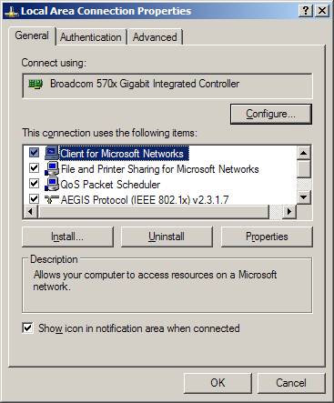

I can ping each other when I go to dos mode. But that is all. How do I access file or program on the other PC. How to configure sharing mode on each PC.

go to networking, right click on your connection and choose properties
you will see something like this (your version might look silghtly different).
you have to make sure that you have installed following clients (top two)
- Client for Microsoft Networks
- File and Printer Sharing for MS Networks
Then you probably have to reboot (don't remember NT anymore, never seen ME but it should be like Win9x).
Make sure both PCs have different names (PC1 and PC2 is different enough) and they are on the same workgroup (WORKGROUP or HOME or MYLAN or whatever you choose).
After rebooting as nececary, open windows explorer, right click on C: and under properties you should see Sharing tab. make sure this drive is shared (give it a name such as HDD1 or whatever).
On ANOTHER computer, choose Mapping from Tools menu and assign some drive letter that THIS computer doesn't already have (Q: or Z: or whatever). As path type in path in following format:
\\ipaddress\foldername
Note that there are TWO backslashes at the beginning
replace ipaddress with address of the FIRST computer (the one that has shared harddrive).
replace foldername with the name you gave it (like HDD1 for example)
this will be something like \\192.168.0.1\HDD1
Hit F5 in Windows explorer and you should see your new drive (Q: for example).
