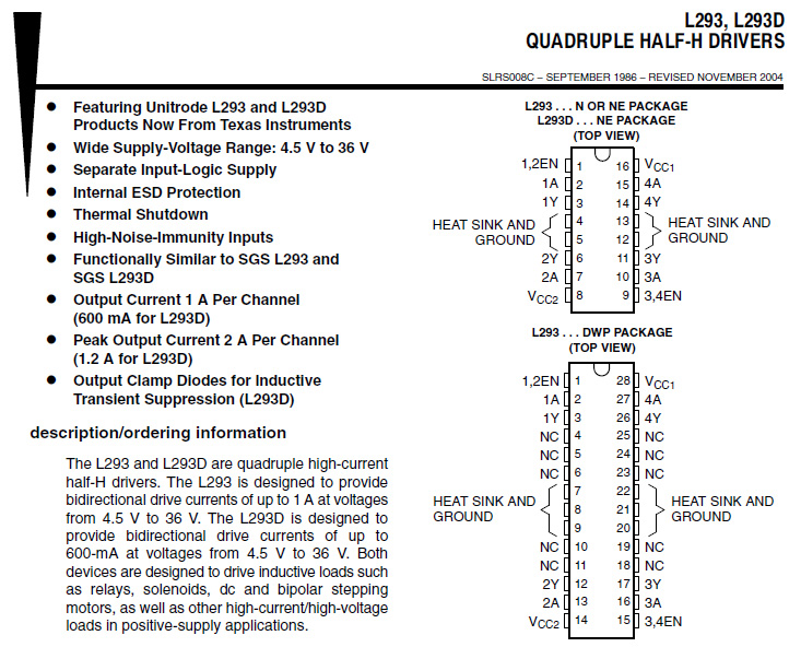

I used L293D to drive the stepper motor. But after one or two minutes the ic got burned!

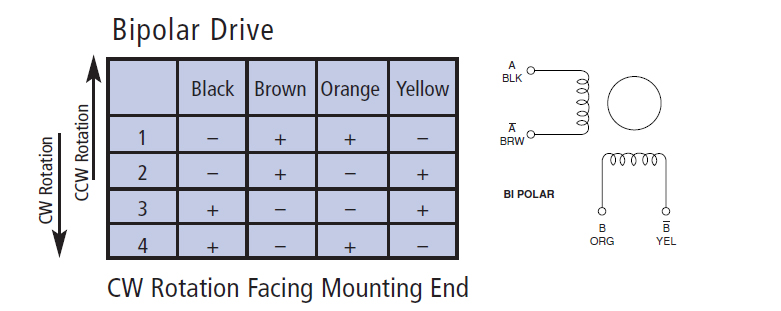

And here is switching sequence from the datasheet of stepper motor.
Looks as though it should work, maybe you need a l298 which can handle more current.
Depending on the motor you might need to use current limit, both l293 and l298 support this, steppers particularly at low speed can saturate and draw excess current.
Now I have to buy some driver, I think! May be some heat sink can handle them better... But unable to think how to implement a heat sink in the DIP PTH package?:banghead:
