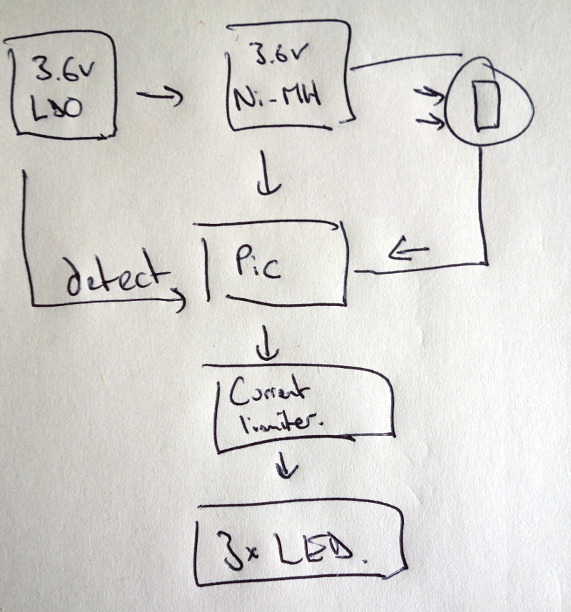

I've attached an image with my thoughts. A PIC is used to;
1. if a signal from the dynamo is detected a 4 minute counter begins. Each signal resets it. If it reaches 4 minutes it enters sleep and watchdog monitors the pin.
2. if awake, an LDR on the comparator pin, plus a hysteresis buffer decides if it's dark.
3. if dark, power is supplied to a current limiter to the 3 LED's.
The part I'm unsure about is charging and drawing power from the battery at the same time. I think this would be more complex using a LI-ion (discharge protection, can't draw at same time as charge), whereas I could slow charge a Ni-Mh to a voltage a bit less than it's total capacity using a resistor (no need to make it more complex I think). Alternatively the PIC could have a capacitor across it's power input and if it doesn't detect power from the LDO then it switches on an output which enables a transistor which bridges the battery to the pic.

I suspect you're GREATLY over-thinking this, and making it far more complicated than it needs to be.
You don't 'draw current at the same time as charging', just as with a car alternator/battery as you draw current it takes it directly from the charging source, and only takes from the battery if there's not enough from the charging source.
However, as LI-ion is more complicated, and easily prone to damage (or bursting into flames :D) - then it makes sense to use NiMh, or even NiCd.
Hi Nigel, re: power source, that was my thinking with Nimh/nicd. With li-ion it's not as simple as there must be discharge protection or the cell is damaged (<3.4v or something).
The rest of the spec is a bit more complicated but solves the issues with the current products;
1. it doesn't dim when the rider stops (as the supercapacitor does)
2. comes on automatically when it's end of day/ dark

Nicad/Nimh would only discharge to the PIC's lowest operating voltage (2v). I still can't see how Li-ion can be used without using the PIC to switch power source. It can't be put in parallel with the li-ion. Weight is a non-issue, even ni-mh 20mA 1.2 batteries are tiny.
Not quite sure what you are saying here. Any battery will discharge to zero volts. In fact if you discharge a NicCad battery too far, not only will the battery be damaged but the battery terminal voltage may reverse.
I suggested in a previous post to run a LiIon battery between roughly 3V and 4V; that voltage will be ideal for the PIC MCU, or have I miss understood what you are saying. :wideyed:

No, but if the li-ion was just in parallel with the pic it would discharge to 2v. It would need disconnecting circuitry like this;
https://www.aliexpress.com/item/5-p...arger-Module-With-Protection/32402397769.html
I don't think you can get voltage out at the same time (also known as passthrough)
Why 2V? Battery cut off circuits are pretty standard. I designed one on ETO recently: https://www.electro-tech-online.com/threads/cut-off-voltage-lithium-battery.147987/ Yes, you can take power all the time until the cut off voltage is reached. As the PIC will be taking a very low current, I imagine a very simple circuit would stop a LiIon battery from discharging below a specified voltage.
spec
2v is the PIC cut off voltage. After that it won't work (so shouldn't discharge the battery any further). I now agree if the li-ion isn't charged to it's max then it's easier to charge, straight voltage across it.
For the UVLO, a darlington and a zener to the base should do it, I think. That'll leave 3v to the PIC, which would give 2.4v at the output pin, which is acceptable (just!) as a 2v LDO exists with a 0.23v dropout. (LED's are 2v rated)
Correction, the 0.23v dropout gives very little room for li-ion discharge. Assuming the li-ion is charged to 3.6v that would give 3.43v before the LDO couldn't keep up and the LED's would dim.
Which may work, they're only on for 4 minutes and the battery would quickly recharge.
