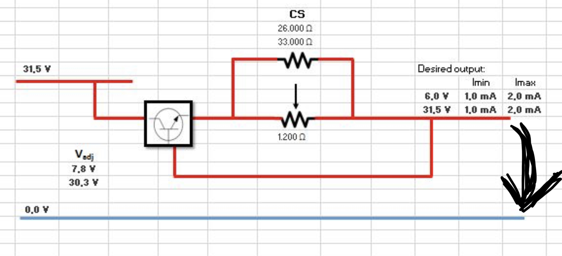

As I wanted to make colloidal silver, just for fun, I tried to make a constant current supply. So my powersupply input is 31,5Vdc, and my desired limited output is aprox. 1000-2400µA.
In my test circuit I use a potmeter to limit the current, and a leak resister to get the minimum load over the LM317, as shown in the picture.
However, Iout keeps running away slowly, but undesirable. I'm a mecanic so I studied many hours to learn the basics and now finally had the courage to ask.
I read the LM317 specs, min 10ma load, Vadj-Vout=1,25V, Vin-Vout dif max 40V, but Iout keeps running up, whatever setting I use.
On the load side is the conductivity of the destilled water, starting low and rising because of the Ag-ions being produced. Resistance aprox 25-30k.
R2 is the leak resistor, creating the minimal load of aprox 10mA.
It would be a miracle to me if it would work, so please can someone help me out?
Thank you,
Richard, The Netherlands.
