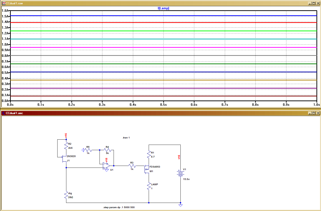

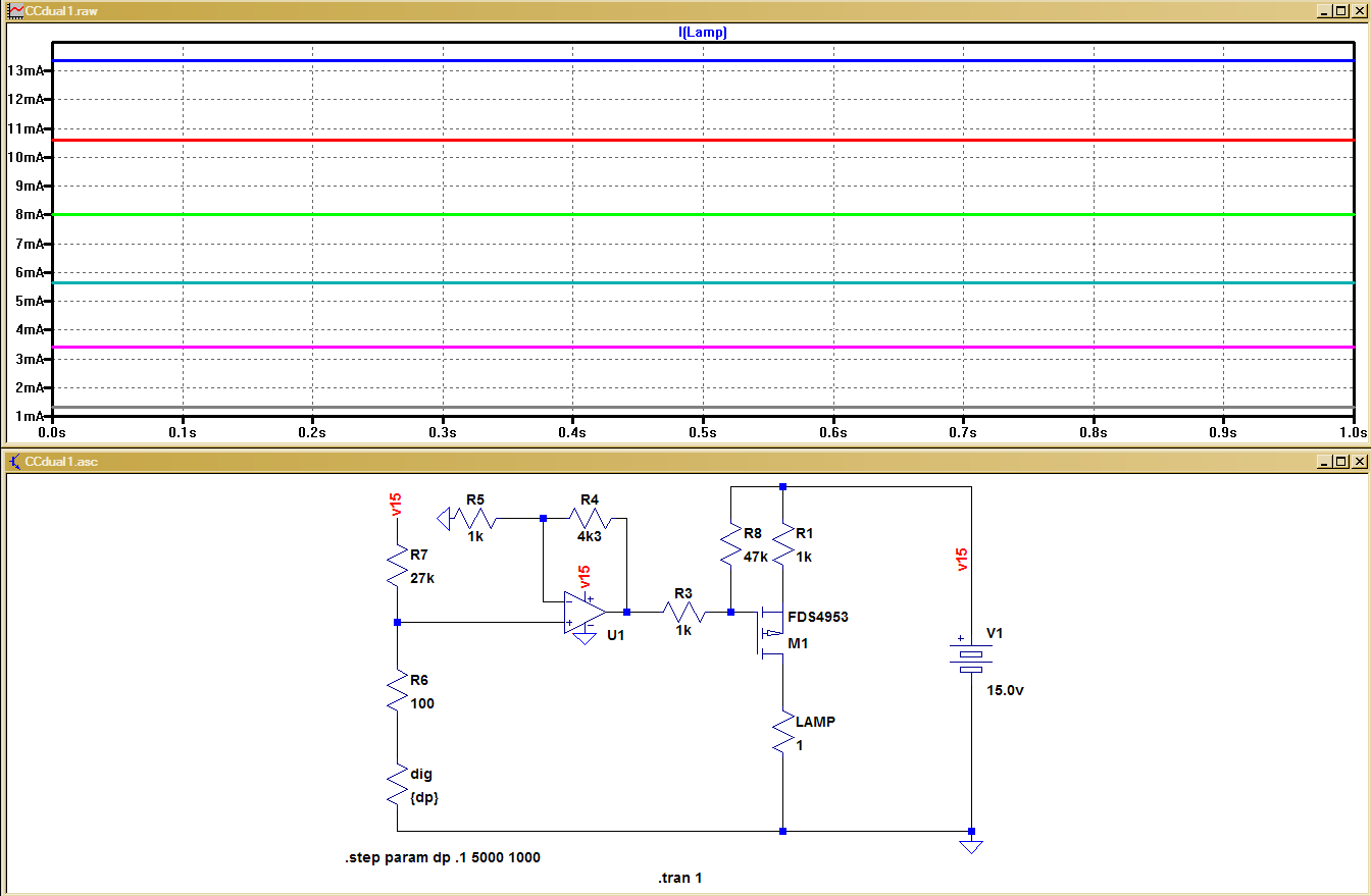

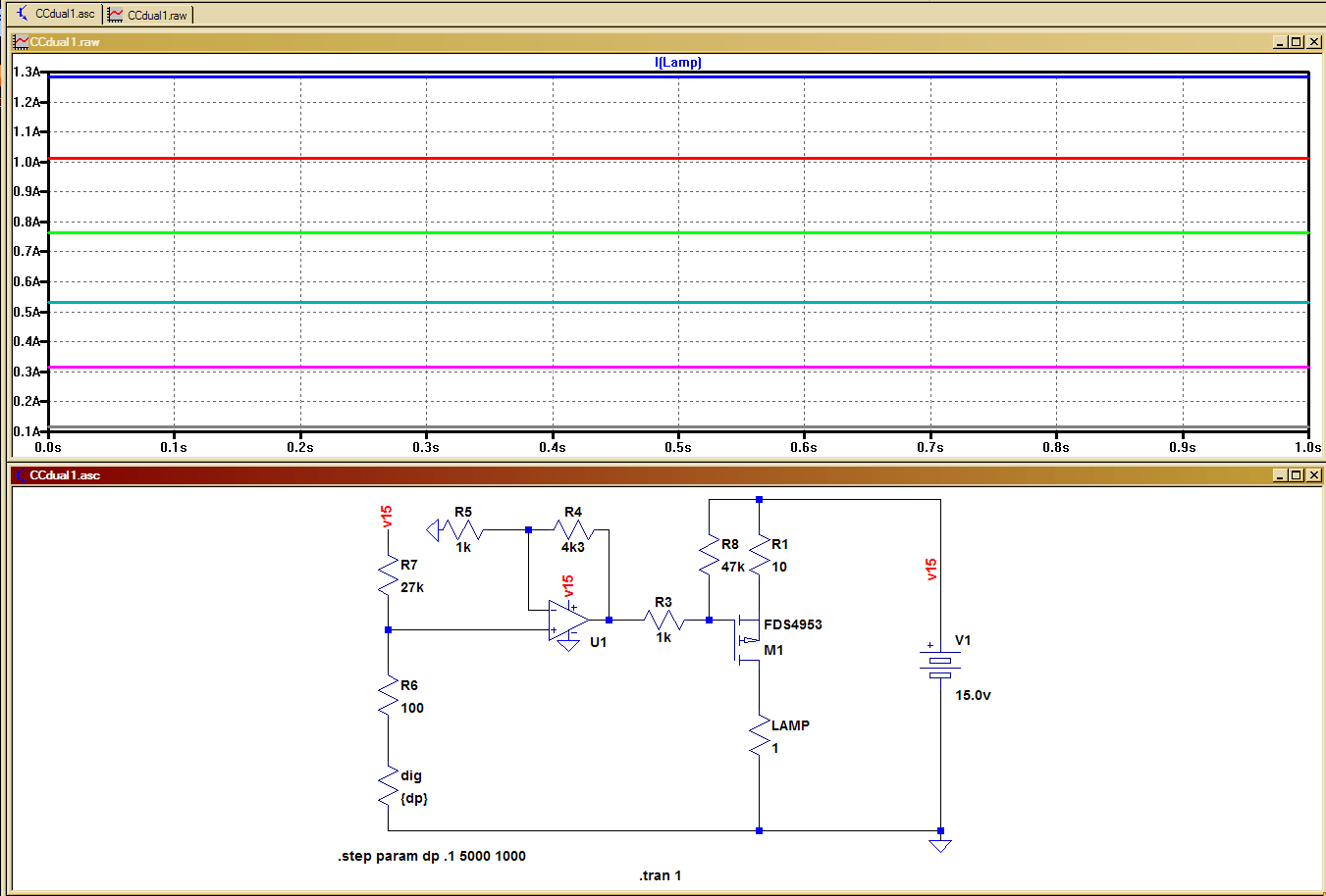

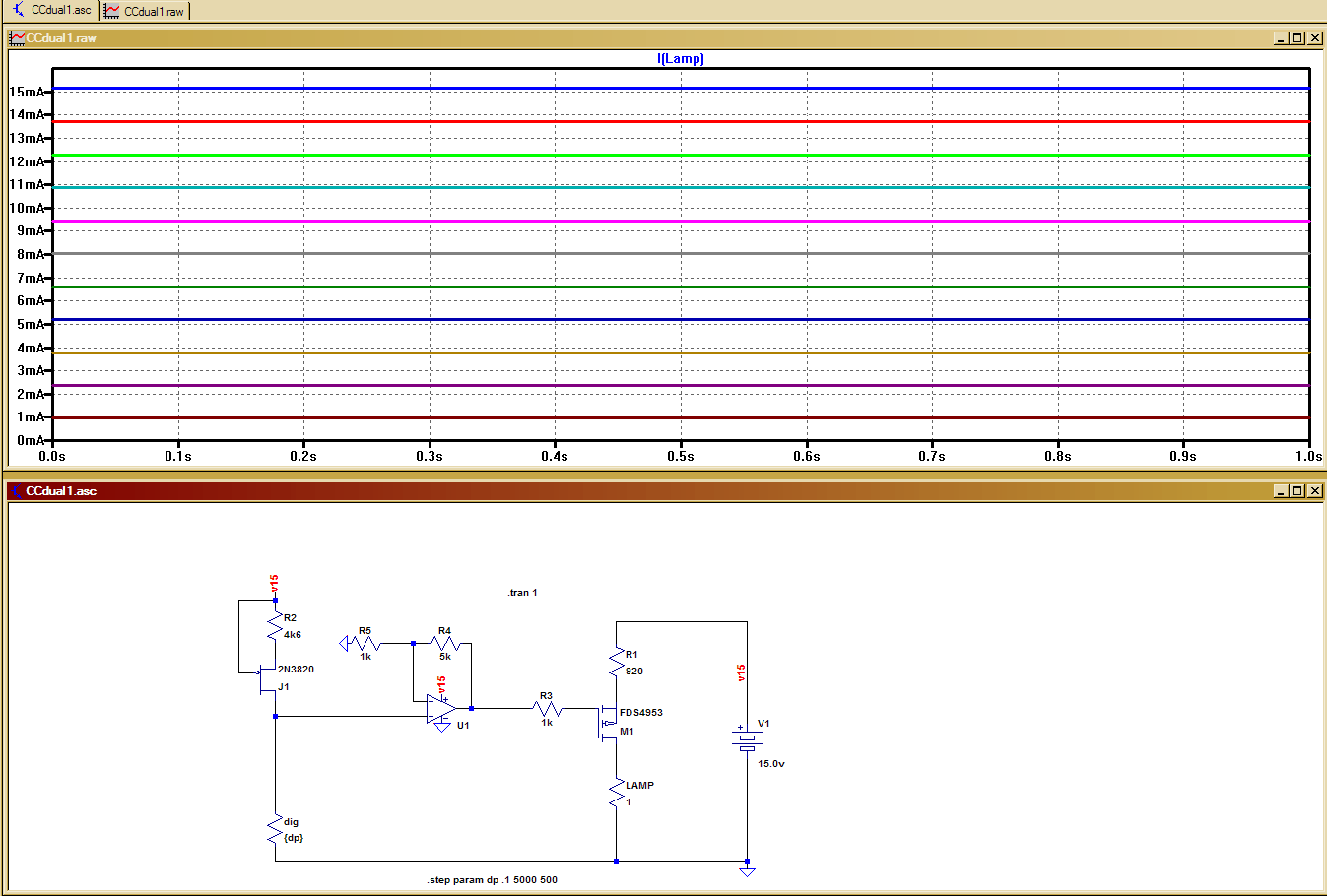

These examples may suggest ideas. using LTspice.
The FDS PMOS is a dual, the only change is the MOS Source resistor 1K or 10R.
The MOSFET will require a 'very good' heat sink for the high current CC
I have assumed a 5K digit pot
Thanks a lot. Really a lot. I've seen the duo at a glance for now, they are just perfect for my purpose. I'll figure out deeply tonight. Meanwhile, can you provide me the equations which you used to calculate the value of the resistors?
You solved me, really :)
I've an idea. Both the two designs can be integrated into a single design. There'll be a relay connected to a PIC pin. The relay will connect one of the two resistors (by given signal from PIC) to the source pin of the FET.
I would consider using a P JFET as a constant current source for the digipot drive, like these examples.
It would help to make the digpot response more linear
NOTE: for the high current CC, the source resistor is running at ~25W !!, so choose a high power resistor, also for the high current CC it will be necessary to increase the 15V supply.
For example at say 1.5A with a 8.7R thats a drop of 13V! so to have 12V across the Lamp and some across the FET you will require approx 30V.!
So choose a power P MOS FET Vds rating and OPA to suit.!!
These circuits are only a guide.

Ok. I'm checking these out. What should be the Vds rating of the pMOSFET for optimum performance? And what why do you suggest OPA?
I would recommend a variation on Eric's circuit with feedback around the MOSFET for better current stability and accuracy as shown on page 2 of this reference. You can replace the JFETS with MOSFETs.
The constant current simply equals Vctrl / R for the left circuit and (Vsupply - Vctrl) / R for the right circuit. This minimizes any variation of the current due to transistor Vgs drift from temperature, etc.
