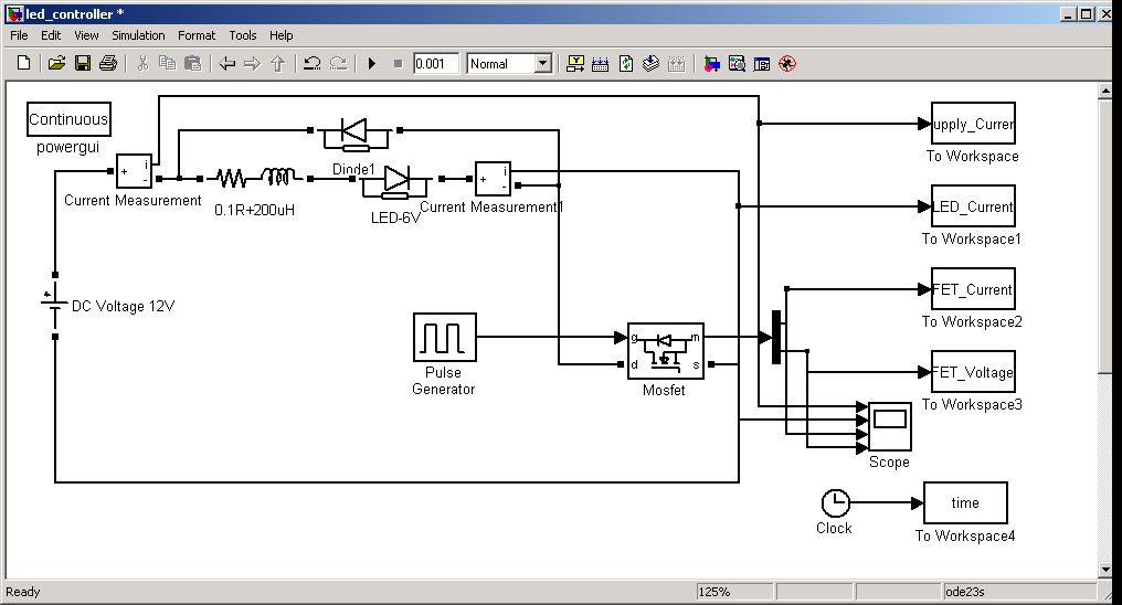

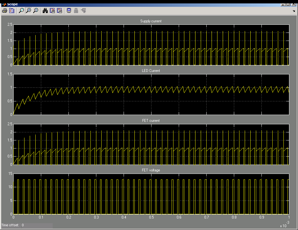

Well here is the Simulink sim info to show what I was talking abt
