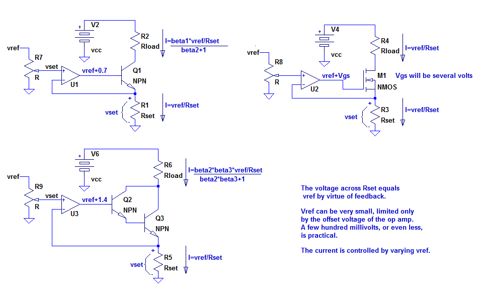

ok.
Is this a constant current source?
g

No, because the current through Rb will vary as the load resistance varies. It will be fairly high impedance, but you can improve it by moving RL to the collector of TR1.
It will be temperature sensitive. The current will vary about -0.3% per degree C.

I tried to find a tutorial on the Internet, without much success. I have designed and built a LOT of current sources in my life, and I could describe some techniques, but I don't know what your level of understanding is.
Do you know Ohms law? Do you understand op amps and feedback theory? Do you understand how transistors work? If you don't understand these, you won't be able to understand how current sources work.

OK, here's what is probably the most common voltage-controlled current source configuration, with several options for output current boosters (you can make low-current sources with just an op amp and some resistors).
There are many other ways to make voltage-controlled current sources.
