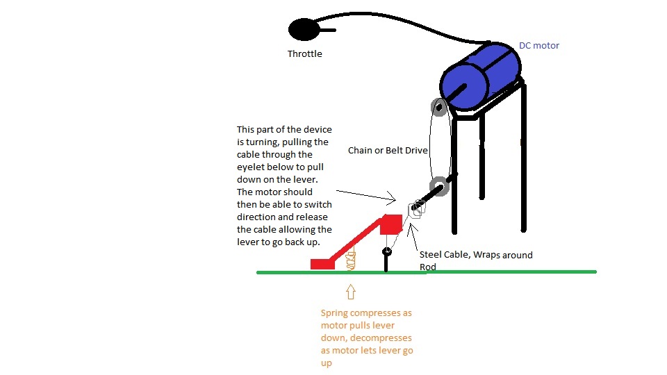

I am trying to design a contraption that has the capability to pull a weight of about 30-50lbs UP a distance of approx 18" and hold for any necessary period of time, then return that weight DOWN to it's original location. It would need to be able to accomplish this task within the time frame of approximately ONE (1) second in either direction. However, I would like to have the acceleration/deceleration in each direction be variable via a throttle mechanism so it could optionally be slowed/sped up a bit as desired.
I was thinking to have this powered by an electric motor so one thing I need to know is what power/size motor would be necessary to carry out this task keeping the weight being pulled, the distance covered, and the time window necessary in mind.
I would think I am going to need a motor, a belt or chain drive, a throttle, and some sort of speed controller. Lately, I have been wondering if stripping an electric scooter would provide many of the necessary parts, but not sure if it will meet the necessary requirements or not.
Some of the other concerns are a motor that can meet the speed needs with the weight requirement, be able to "hold" the weight in place, and reverse it all in a controlled adjustable "on the fly" manner via preferably some sort of thumb/finger operable throttle.
Any guidance any of you can lend in this pursuit of contraption insanity would be greatly appreciated. I also would like ot be able to keep the contraption as small as possible, but low cost, and 12V battery operated.

The calculations are pretty easy. I'm going to change to SI units first because it makes it even easier (hope I don't screw up). You have about 20kg and you want to move it about 1/2 meter in one second.
With normal gravity, that's about 100 Joules of work, or 100 watt-seconds. You want to do that in 1 second.
Let's see what it takes to accelerate 20kg to a velocity of 1/2 meter per second. That's (MV^2)/2, or 20*(.5^2)/2 = 20/8 = about 2.5 Joules. Doing that in let's say 1/10 second would briefly require 25 Joules/sec. I think we can expect it to stop due to friction when you remove power.
Summary: To lift the load, you need 100W of motor output, plus another 25W briefly to start it. If you assume the motor rating is continuous 250W input with a peak reserve, and the motor/gearbox is near 50% efficient, then it is about right but with very little to spare. It also assumes that all this is designed with a gear ratio that uses the best spot in the motor operating range.
Worm gears are usually good for resisting the tendency to fall when power is released.

If you use a worm gear, plan on having to reverse polarity to the motor and driving it down. The full load can rest on the drive shaft worm and it won’t move; there is just too much friction and mechanical advantage.
No, worm gears work in both directions. Think of a crane or tow truck winch. Short of using some kind of ratchet to lock the cable drum, a worm gear is the best way of holding a load. Plus it will hold at any position, where a ratchet is limited by the notches in it's mechanism.

Stalling a DC motor for a 'few seconds" is not good.
Try to re-word your problem statement to use Mass and Force properly instead of using Pounds for both (damn imperial measurement system) we (and you) might be able to sort it out better. (When a pound is mass, divide it by 2.2 and call it kg, when it's a Pound of force, multiply it by 4.4 and call it Newtons.)
Can you draw a diagram?
Where is this spring in the scheme of things? A worm gear is usually pretty powerful, you could break something if it isn't being monitored while in use. It's not a good idea to just let something run while it's at its limit, it will put a strain on the motor/gearbox, the cables or the frame work of your "contraption."
How about a sketch to show what your really after? That will help use better help you. what country are you in?
"Contraption" ;) Sketch
Okay gentlemen, I guess you are right a sketch would certainly make things easier to understand so here you go. It's definitely a rough sketch done in Microsoft PAINT, but hopefully you get the idea of what I am imagining.
The lever or "weight" that is being pulled is marked in red and you can now see where the spring comes into the picture. So as you can see it's not the physical weight of the object that is creating the load on the motor. Most of the mass the motor is pulling on is to overcome the spring weight.

Your over complicating the "contraption".
If you want to lift the weight the spring is just adding another amount of weight to the job.
If you want to compress the spring the weight is not needed.
The reason I asked where you lived is sometimes people ask for help, and if you source something from the US it's not available where they live.
Maybe if you explain what the final out come of this machine is, I mean what is it going to do, you will get more help. I will help as much as I can with how to do it, but without knowing for sure what your trying to accomplish it's hard to give a real answer.
I have added a bit to the sketch to explain a bit better hopefully for clarification. The steel cable through the eyelet is intendeed to pull down on the lever as it wraps around the rod in a similar fashion to how a winch would operate.
As for the spring, unfortunately, it and the lever are an already existing assembly. i am trying to design this contraption to power them instead of manual operation. Therefore, I can't eliminate the spring as it would make the lever impossible to operate manually as it would no longer return to the up position. The spring compresses as the lever is pushed down and decompresses as the lever comes up.
