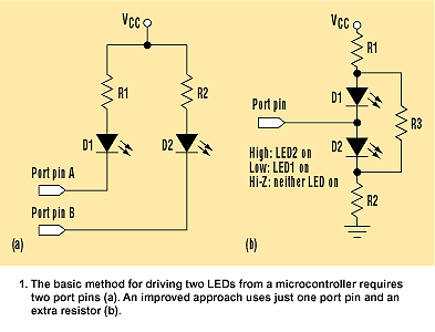

Here's a simple circuit than can switch two leds with just one MCU pin. When the pin is high, LED2 is on, when the pin is low, LED1 goes on.
All you need is an extra resistor. The formulas for calculating them is on this webpage:

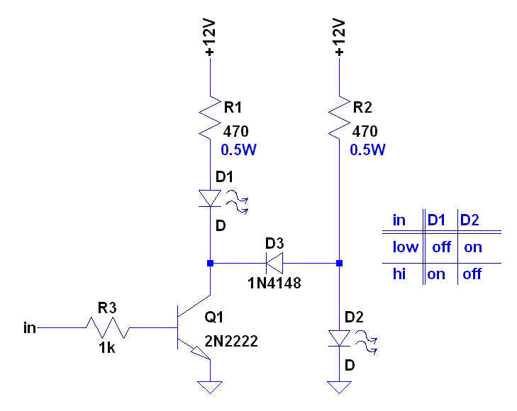

If it is important that the LEDs run off 12V, you can do it like this.
It's not very efficient, but it's pretty simple.

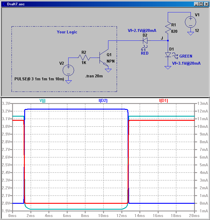

Here is my entry into the two LED derby: As long as you use LEDs with different Vf , this circuit relies on having the one with the higher Vf in the D1 position. When the logic pin is low, D2 shunts the current away from D1.
