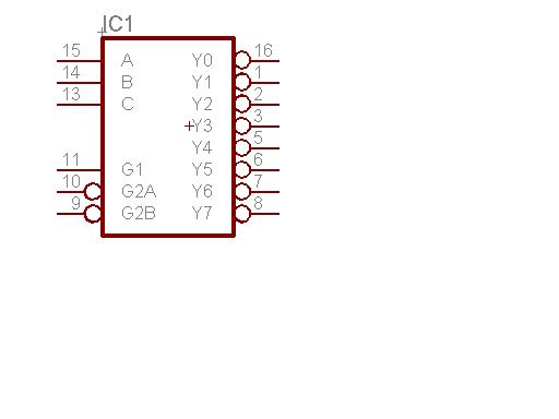

It seems like you are going to have to develope your own protocol..
what i mean is the hardware needs some way to distinguish what data is going to go to what Display..
a 3x8 decoder can route the data to each display
there is a million ways to do this that is the problem..
ok right from the start .. do you have the ability to ' Talk ' to to parallel port , without any interference from an intermediary program..

if you can output a three bit value designating which display the data is to go to that would be a start..
it might go something like this..
you send an eight bit value value out to the parallel port..
three of those bits I can decode
once decoded i will know that the next four characters are going to display X..
then you send the four chars ..
then you send another control byte with the info i need to know where to send the data..

Okay, is that what you mean by a 3x8 decoder?
3 bits signify the address
and then 8 bits to signify the value of the display?
Ohhhh, I think I need a drink tonight!!!!!! :)

sort of..
the 3X8 decoder uses three values A, B , C are inputs..
Y0 through Y7 are the outputs Used to select which display to use ..
make any sense?
How many different sets of displays are needed?
