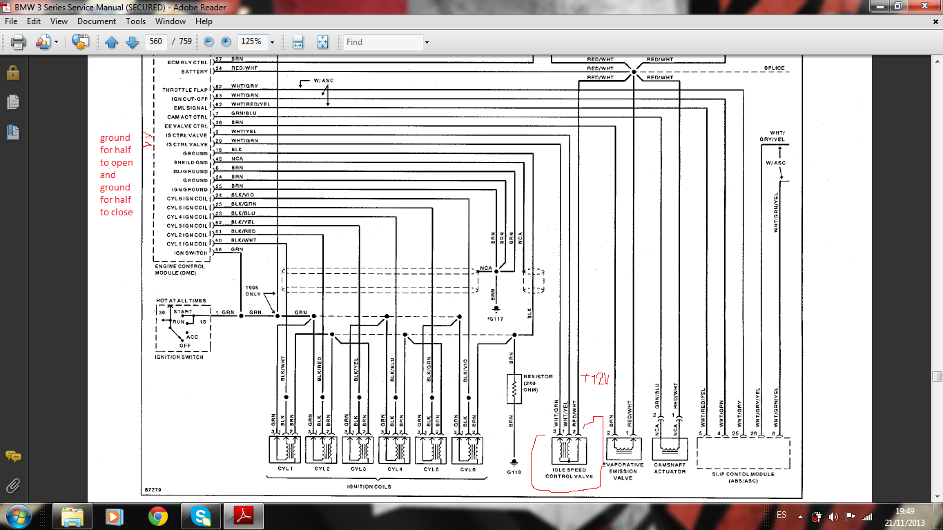

Ronsimpson, when get no power (standby) its always half open, if you give one mass close if you give the other mass, open. If you connect 12v from a batt direct, open direct, in milisecons. I'll try to get a picture this weekend, anyway I leave here the original wiring diagram, and one link where you can see some fotos.

Anyway, I want found a solution to control it manual as simple as possible, thanks a lot and sorry again for take to much time. bye
Wiring diagram:
