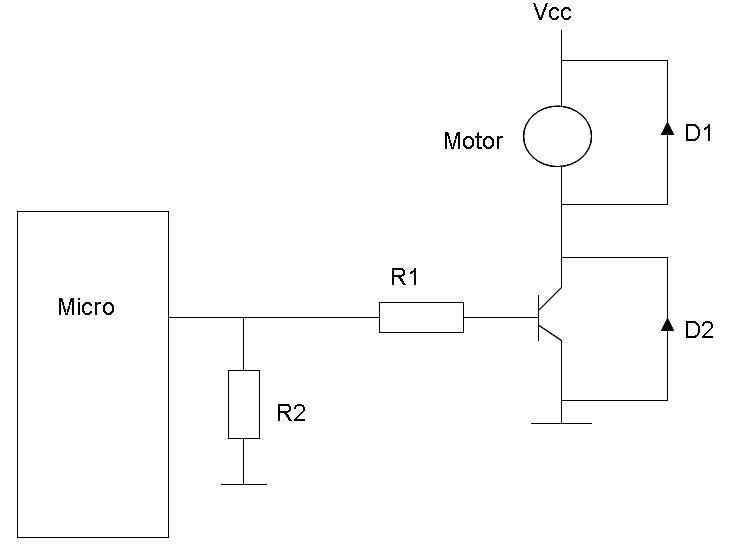

2) talking about simple circuits (not h-bridge) take a look at the attached picture
2a) is R2 really necessary? i got some docs saying it is , other saying it isnt
2b) is D2 necessary?
2c) some book recommended putting a condenser in parallel to D1, but I wonder if that is a mistake of the book
3) Talking about the circuit in 2 and also about the H-bridge (either the chip or the one built with transistors) since this motor is 6~12V, should I use an opto-coupler to separate the chip from the motor as I did in my previous project?
btw, when the datasheet of the motor said 6~12V does that mean that I have to put 12V and only get the 6 V through PWM the signal from the microcontroller???

1. someone has already done all the work for you.
2a It's required at powerup when the I/O pin is an input. However, not really needed with a transistor but is needed with a MOSFET.
2b not needed
2c probably helps if the diode isn't fast enough. Also helps reduce RF.
3 Keeping the motor supply and the logic supply separate would be a good thing. Most people just filter the logic supply.
Yesterday I started trying circuits for the motor (in the figure). The motor can only work in the ranges of 6v to 12V. I am very confused so I would appreciate any help.

I tried no R2. And for R1 I tried the following and I got the following voltage accross the motor whe applying 12V (not 5V) to the base

obviusly i could only move the robot with the 100 Ω resistor.
Now ok, I moved it but I am worried since I have to control the robot with all kinds of voltages from 6v to 12V. And also i have to control it with a microcontroller (providing only 5V)
my question is how can I increase the voltage passing through the motor? So far the only thing I have tried was changing the R1 resistor. Can someone enlighten me?

The transistor has to be Darlington such as BD679.
Vcc can be 6v to 12v. R1 is 10k for BD679. The motor need a very heavy current to start-up. That's the problem - that's what no-one will tell you.

You have a couple of problems:
1- From your numbers it looks like your motor has a locked rotor current of nearly 1 amp. Your transistor is only good for .1 amp.
2- The Hfe of the transistor is 30 which means you can only get 30 time more collector current than you have base current before it comes out of saturation..
A better solution might be a logic level n Channel Mos Fet say maybe a IRLD024PBF. This would solve both problems.
You could then control it with a PWM from your micro- not an analog one but a digital one.
