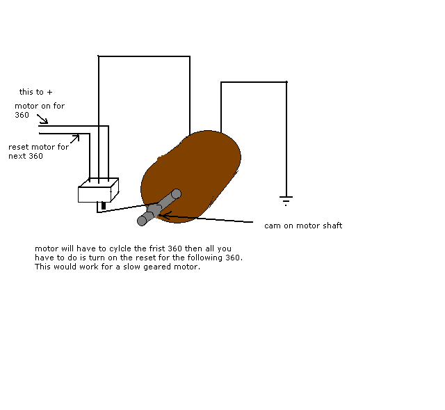

How would I go about turning a DC motor 360 degrees with the click of a microswitch each time?
You'd need some type of encoder wheel, like those found in an old ball type mouse. Shine an IR beam through the wheel, apply power to motor, count number of times the micro sees a flash.
I think it's easier than that, one switch on the motor and an edge-triggered flip-flop.
You have to be able to stop the motor if It is a slow gear motor you could use a cam on the shaft and dpdt switch. If the motor is fast you would have to use You'd some type of encoder wheel like Noggin said with a h-bridge that can brake the motor.
Some thing like this would work. The switch is powered to set the motor the first 360 when tripped
it will stop and wait for reset for the next 360.
if the motor is fast he would need a good controller since while it would stop it would not be clean, most likely having a damped oscillation every time it stopped.

Like I said it's hard to control a fast motor. That's why there are steppers. A slow geared motor you could use a cam and a switch to to stop it. Like Nigel said
timing just doesn't work, it's far too inaccurate.
What I showed you will work the motor is turning about 100 rpm or less it's not the best way but it is easy to do and the motor can keep going fwd after the stop.
The pure timing thing doesn't work, tried it many times.

You can go faster about 3 times then what that gear motor is turning.
