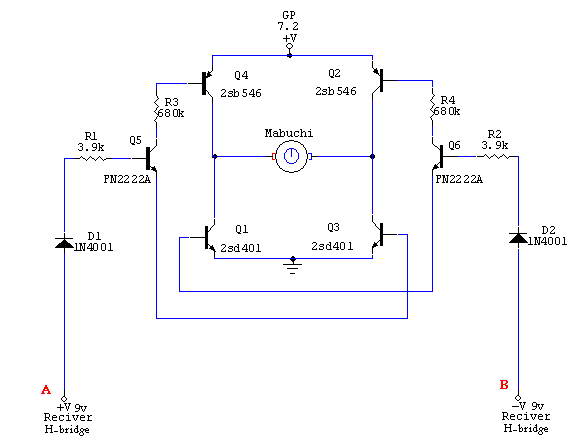

I Want to use A cheap rc car (transmitter & reciver) to control A Small robot
the problem is due to high power source i want to use(gp 7.2v 1600 mA battery)
which the two H-bridge circuits , the reciver chip shown in the circuit below aren't able to
handle that much current
so how to make the reciver circuit only control more powerfull h-bridge ( a tip's 102 & 107 or
mosfet transistors) provided that each circuit uses it own source of power
reciver circuit operating at 9v (6 aa batteries) 600 ma & a tip's or mosfet H-bridge operating at
7.2v 1600 ma
the reason that i want seperate sourcres of power is that im afraid that the reciver chip
aren't able to handle that much current (it mighty get fried)
should i use the ouput of the rc reciver h-bridge to control the tip's/mosefet h-bridge
if this is possible how ? i'm using a Mabuchi motor for throttle
included the reciver circuit,

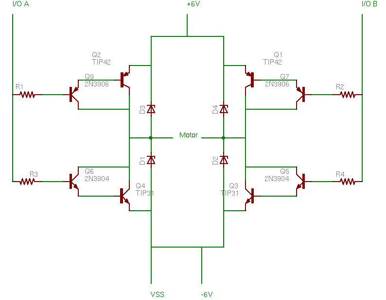

Mr_Max said:
here is the h-bridge circuit i want to merge with the radio control reciver
http://www.mcmanis.com/chuck/robotics/tutorial/h-bridge/bjt-circuit.html
please tell me which wires to connect & components that needs
replacement.
It looks difficult to do?, the H-bridge circuit at the link above is quite unusual, it requires manipulation of three pins to control it. You would need to design a logic system to convert between the two systems, or find a more 'normal' H-bridge design.
just connect the Enable pin to vcc (or GND whatever it need) and dont turn any attention to it. then connect the H-Bridge and the way you go

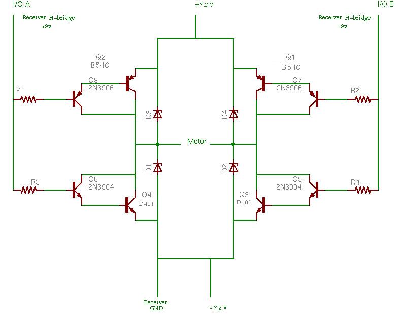

yes the BJT circuit is confusing ! but this is what i found.
Any H-bridge circuit that can handle the 1600ma current & the mabuchi
motor would be fine .

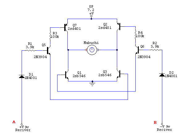

what is your opinion :- [NEC] 2sd401a & 2sb546 Based h-bridge
here is the datasheet
& the circuit
if any one knows a beter h-bridge that works please let me know.
& please i wish to know if the idea of 2 seperate sources of power would work or not? 7.2v to external h-bridge & 9v to receiver circuit
this circuit is my trial i don't know if it works if any one cant tell me if it does?
the idea is that by connecting the output of the reciever h-bridge (2 wires red & black)
to (a) & (b) so when i press for ex. the (throttle) forward button say point (A) would be +9v
& Point (B) would be -9v so the diodes allow the +9v & block the -9v & vice versa
thus simulating the 0 1 1 0
as i said it is only a trial i don't have much experience about Electronics

I can't just change the transistors in the original schematic
because i'm afraid that the 1600ma current might fry the reciver chip
if a short happens in the circuit ?
but if you see it possilble let me know that would be great
what do you think about the NEC Transistors that are able to hanldle a 3A
current I have bought them already but i didn't solder it yet!
could these transistors be used to make H-bridge of any form
I'm sorry for that mistake in the NEC H-bridge circuit the upper & lower transistors were reversed ,i hope that this one is correct
please tell me if there is any thing wrong with this circuit & how to overcome it?

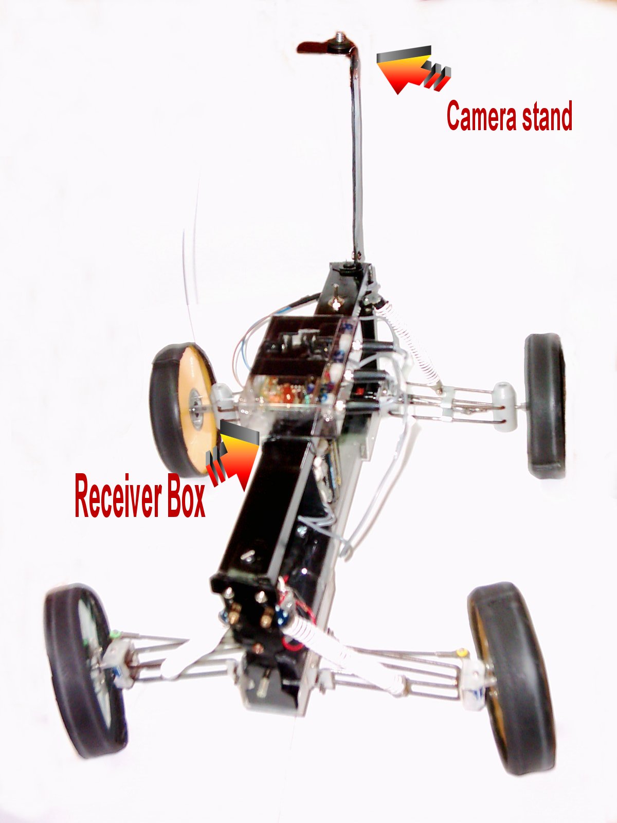

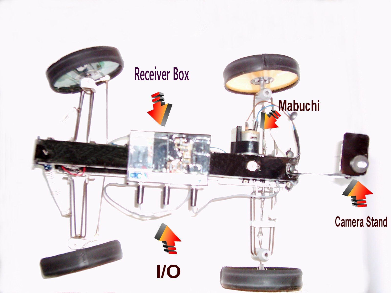

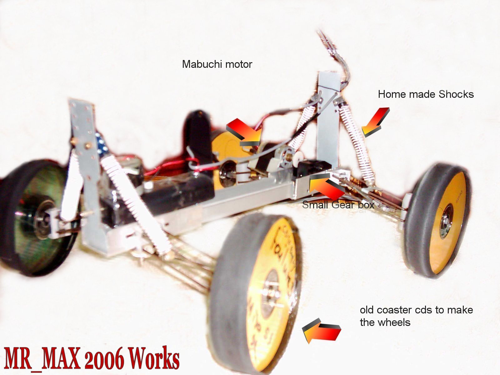

I'm using this R/c transmitter & reciever circuits to control a small robot i made.
For throttle i'm using A (Mabuchi Motor) & for steering i'm using a small (powerfull) old
recorder DC motor both motors are geared.
it's a 2WD robot (2 wheels at the back 11cm radius) connected to a gearbox thorough (4 Rods & 8 joints)
& for steering (2 free wheels 11cm radius) connected together by (2 Rods 4 joints) & to the steering motor (a real car steering type)
the reason i built this robot is to simulate a real car or truck mechanism .
as shown in the provided picture there 4 shocks & the movement is transferd to the back wheels
through 2 axles so if there are small rocks in the way these shocks works great providing
A travel Radius up to 6cm (rear shocks) 4cm (front shocks)

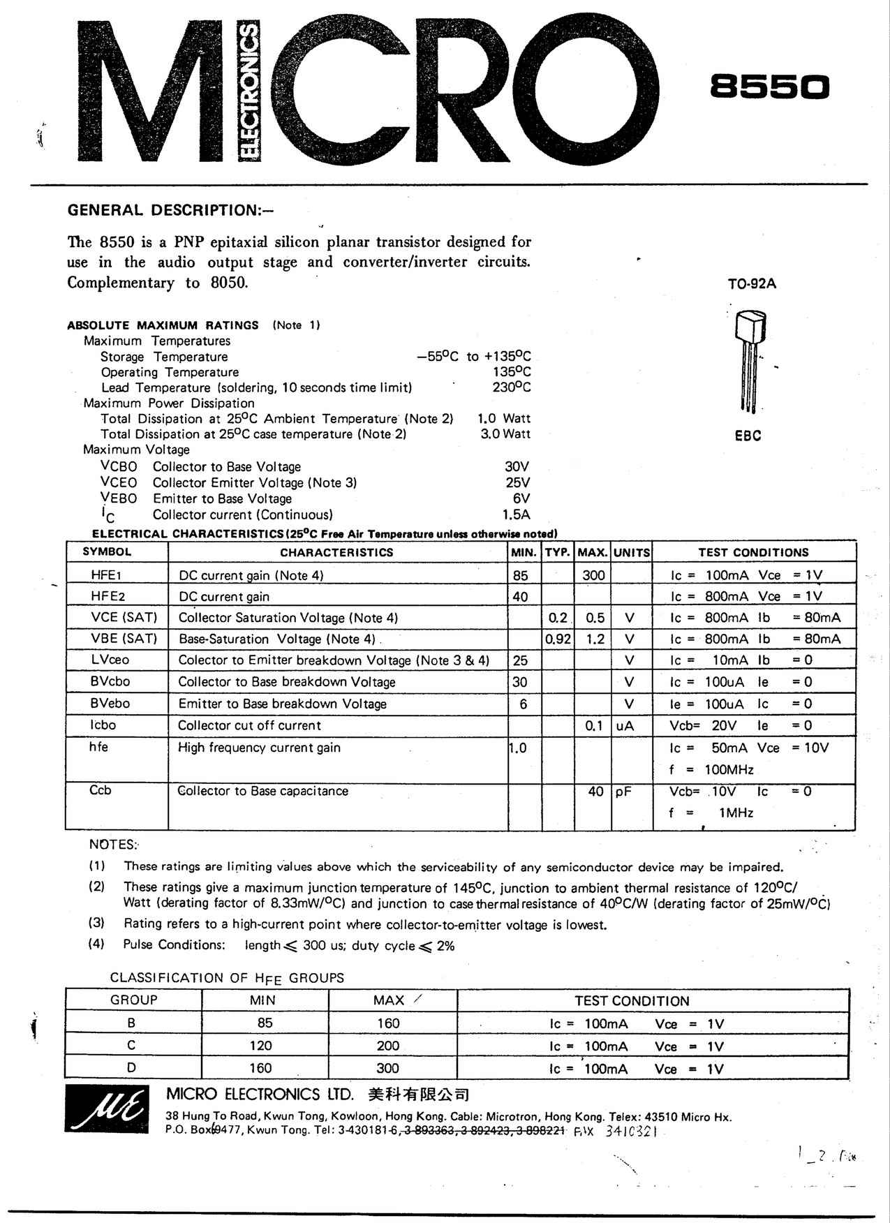

note: the old h-bridge transistors data sheets S8550,s8050 & s9014 are included
i hope this could help!
i'm sorry but i have so many things in mind with regard to this topic ,is it possible to
use the s8550 & s8050 to drive the (NEC) D401 & B546 H-bridge

the chip suply voltage is 5V max. you cant connect it to 7.2V ever! put a low dropout regulator betwean. for the transistors use the ones stated in the RX.-2B data on use relays driven by transistors given in the datasheet. relays can take biger currents than transistors. how to connect a relay to the transistor i hear you say? use the internet. it is full of all kinds of examples and theory articles. learn the simple principles of electonics. it aint that hard you know.
Just to confirm if i just replaced the old transistors with the D882 , b772 & put a Low Dropout Linear Regulator
i could attach the 7.2 gp battery & have no fears of melting the transistors or the rx-2b chip? :idea:
one more thing in the chip datasheet page 10 the supply voltage colud be 9v or 12v but there is a resistor that have to be changed
9v 220ohm
12v 330ohm
would this FAN1086 Low Dropout Linear Regulator be fine?

Hi
Your original circuit should work fine. The tip107/102 darlingtons are rated for 8 amps, so as long as your motor doesnt draw more than that (and I doubt that it does), you should be fine. You dont have to worry about "frying" your chip because the motor current doesnt go through it. The chip just sends a low current control signal to the darlingtons - THEY handle all the motor current. Your 1600ma battery may be the only limiting factor in this setup.
