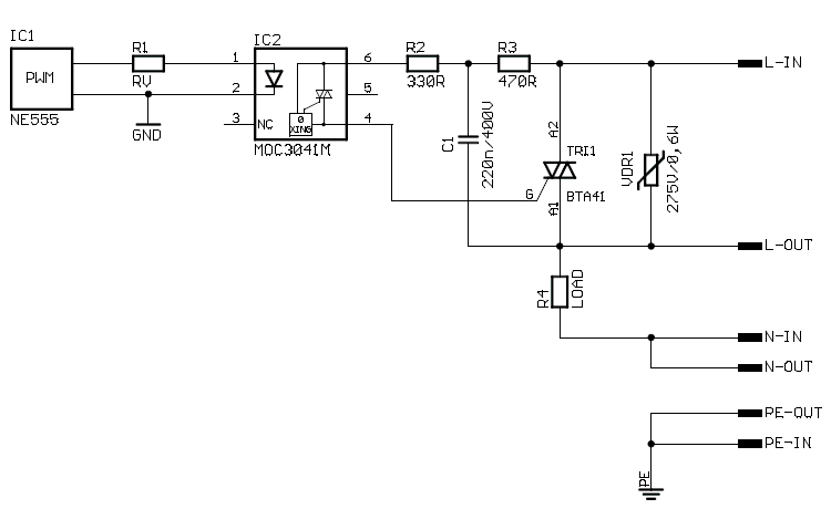

I was thinking of using a 555 timer with a varible duty cycle circuit to controll an electric hot plate of about 2000 Watts @ 240Volts.
It will be running for up to 9 hours at a time.
I only have experience with using transistors and relays to power my circuits.
I don't think they are good enough for this application. (transistors need heat sinks and relays wear out.)
Is there a component that would do the job that does not require a heatsink?
thanks.

Use a solid state relay (Sharp S202S02). It has a built in zero crossing unit and can switch up to 8Arms (with heat sink). Required LED current is 20mA at Uf=1.2 to 1.4V.
Use a maximum of 90% duty cycle not to exceed the maximum allowable current.
Otherwise use a BTA41 triac (up to 40A) together with a zero crossing optocoupler (MOC3041M).
Try to get the timer output frequency close to 50Hz to prevent triac misfirings.
Otherwise use a MOC3021 (w/o zero crossing unit).
Boncuk
