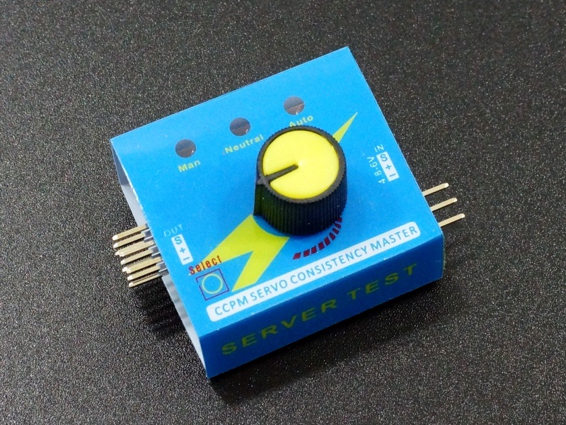

Hello, I have a project at school which requires me to be able to control a servo motor wirelessly using some form of a potentiometer. I made a prototype using the fs1000a sender and receiver, with a 9V battery, voltage converter, servo tester and the transmitter on one side, and a 9V battery, voltage converter, capacitor, receiver and the servo motor on the other side.
Using this setup with both original and extended antennas yielded poor results. The range didn’t seem to be more than 40-50cm, and the servo was shaking and spinning mindlessly.

The servo uses the on/off duty cycle of a 50Hz square wave signal typically used to set the position of the servo.
How are you encoding the duty cycle information into the RF carrier wave?

The chatter suggests an unclear implementation of a communication protocol on the sending and/or receiving side (or, no clearly defined protocol was used in the first place).

I assumed using one of these in the transmitting end would be enough?
On the website above, 50hz was mentioned, but I couldn’t find any information about the “duty cycle information”. Could this be the problem
