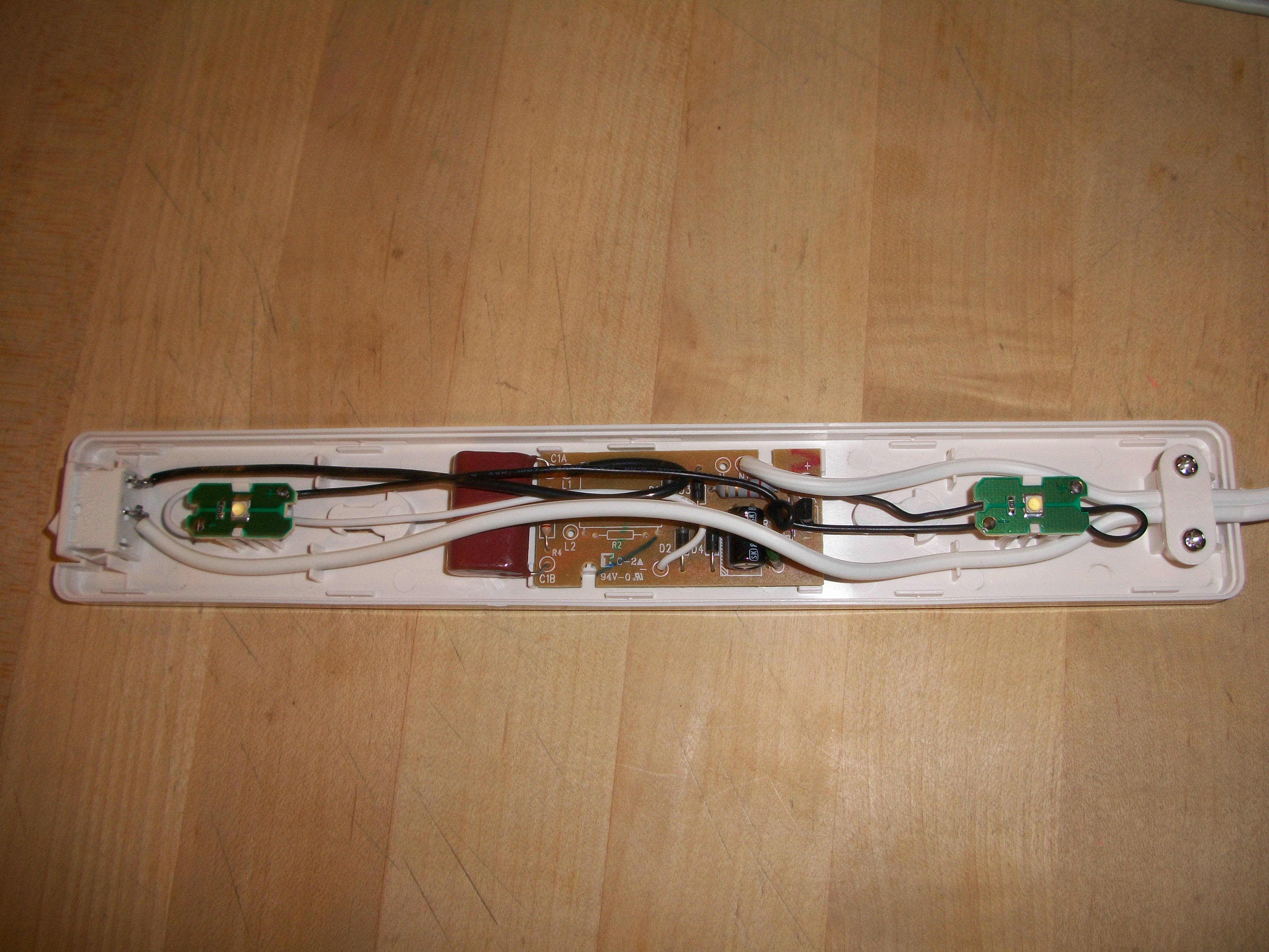

I have a 120v 1.5 watt led light strip (only 2 led's) that I want to run directly from a 12v battery charged by a solar panel. I don't want to power it thru an inverter.
What do I need to remove and add. How to wire? Resistor size? I have KOA Speer 1.0 ohm Thru-Hole Resistor Carbon Film 1/4W 5% CF14-J resistors and I have 12v switch to replace ac switch. Thanks for any help.

what you have is classic non-isolated power supply using capacitor (big brown part on the left side of the PCB) to drop the voltage.
to run them on DC you will just need a series resistor. to estimate value of resistor it would be good idea to take current reading and forward voltage drop of the LEDs
Thank you for your reply. Forgive my ignorance but are you saying to put the resistor in series with the two led's and bypass the PCB? Thanks
yes, that's all you need but the resistor need to be sized (resistance and power)
R=(Vs-Vf)/I where R is the required series resistor, Vs is the supply voltage, Vf is the total forward voltage drop, and I is the diode current. so for a pair of LEDs that operate at 3.5V forward drop (each) at 100mA, and a 12V supply... the total forward drop of two diodes in series is 7V, so subtract from 12V and you have 5V 5V/100mA=50 ohms. the power dissipation of the resistor should be 5V*100mA=0.5W. with a safety margin, and using a standard value from the E24 series of resistors gives you a 47 ohm 1 watt resistor. the current will be slightly higher, but not enough to be an issue, although if you want slightly less current use a 51ohm 1 watt resistor. you will find the 47 ohm more commonly available.

after re-examining the picture you posted, i recommend re-calculating for 25mA at first. those LEDs are smaller than i thought at first glance. so you should go with 200 ohms as a starting point, then see how the brightness compares to when they were running off the line supply.

I started with a 200 1/4 w resistor and compared it to the electric version and it seemed to be 50-60% less bright...I ended up using a 51, 68 seemed slightly less bright 51 may be slightly more bright...very hard to tell. The housing at the resistor end gets warm. The electric one doesn't get warm at all.
capacitive droppers don't dissipate (much) heat as it's a reactive rather than a resistive component and tends to act more like an AC current source.
