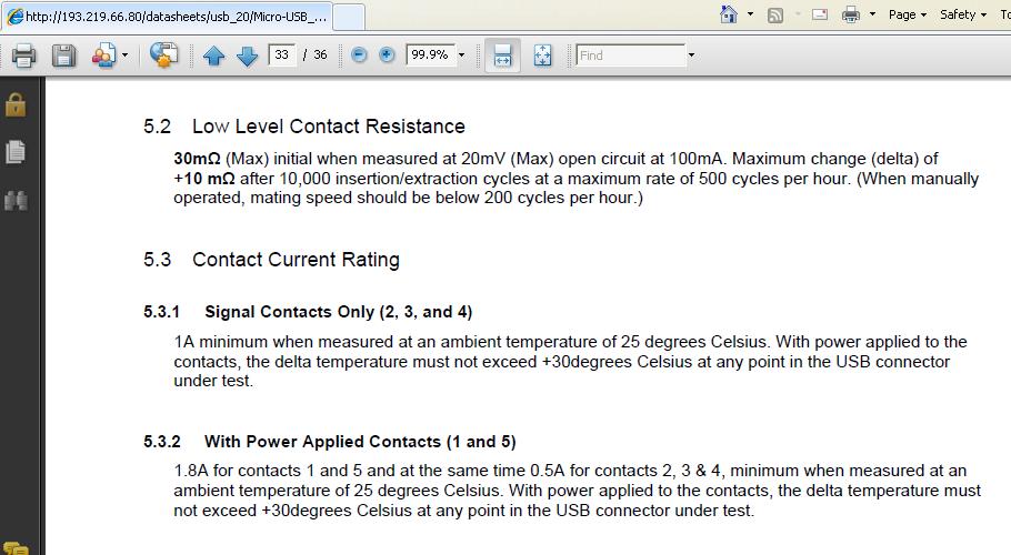

the attachment on the right IS the USB standard, which states 1 amp on signal pins, and 1.8A on power pins.

no, the attachment on the left is the connector spec... the attachment on the right, and in my last post, IS THE USB STANDARD. Now, it does give a 1.8A when power applied with 500mA on the signal pins, and thermal rise not to exceed 30°C.
And I am not arguing that it will ever come close to charging a laptop, just that this is the USB standard... every phone charger I or my kids own rate the output at 5V and 1A.
I don't read wikipedia... I go straight for the KNOWN standard (I left the file name in the clip so you can see that it is the USB standard, not someone's interpretation of the standard).
Here is the entire standard if you want to peruse it... my clip came from page 33

Thats just part of it.
"MicroUSB Specification to the USB 2.0 Specification, Revision 1.01" The power box has full size ports.
and page 33 is the "Compliance Requirements" How hot thay can get under a certan load. Not the max current spec. or even the recomended max current.
None of witch have anything to do with what we are taking about.

max current ratings you mean, and it has everything to do with what we are talking about... you said max current rating was 500mA, but why would they rate the temp rise at 1.8A if the MAX is 500mA. The section is titled: Electrical Compliance Requirements, and the subsection is titled: Contact Current Rating... current rating... max contact current rating... and every max current rating is given with a thermal rise, pcb board trace width has 3 maximums, one for a 10°C rise, one for a 20°C rise, and one for a 30°C rise (for a given copper thickness). The NEC specifies wire sizes for a given current rating based on thermal rise. You can run more amps through the wire than is specified, right up to the copper melting point, but you're gonna inflame the insulation and surrounding building materials before you reach that point.
