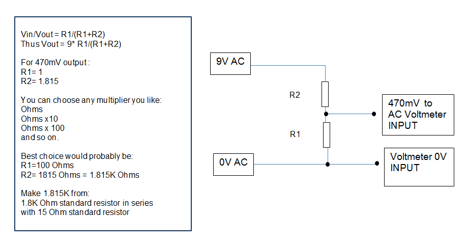

I am using voltage transformer and I want to use this as current transformer and transformer gives 9 volt ac and i want 470mv as output. what is combination of resistance

Hello paridhi,
As underlined in your post above you say you want current but then you say you want mV This does not make sense.
Please tell what you want to do, give as much information as you can, however trivial. Are you simply reducing a 9V signal to 450mV if so we need to know what the load is.
So you want a 470mV output from a current transformer.
Do you mind telling us at what input current? :rolleyes:

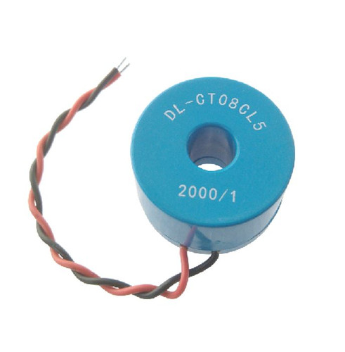

Didn't know you could do that. You can get a standard current transformer from Ebay for next-to-nothing:
I used one in a recent design to turn on a vacuum extractor automatically when a 3D printer operated. https://www.electro-tech-online.com/articles/main-slave-controller.759/
