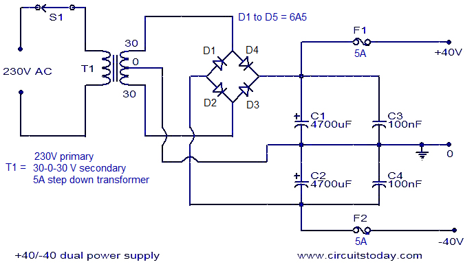

Hi
IS it possible to convert /modify this circuit --30 -0 30 volt AC out --transformer /diode bridge /caps
to a 12 volt (13 .6 volt output DC ) Battery charger --with HIGH AMPS ---IE ----5 -10 amps DC
( IE power battery charger ?)
SEE SCHEMATIC ATTACHED -------
can anyone add /remove /create a battery charger circuit ----using this 30 -30 transformer ---?
Will be very grateful -------
best regards ----Zamdude

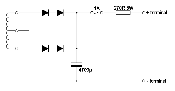

Yes. Replace the 30 - 0 - 30 transformer with a 10 - 0 - 10 and just use one output.
I presume you can't get another transformer for whatever reason. You could do this:
The charge current should reduce to about 100mA once full charge is reached. The battery will drag the volts down to its terminal voltage. But remember:
1. Do NOT be tempted to put the diodes in parallel.
2. You MUST disconnect the battery when it has charged up (use a voltmeter - should be 14.6v) which might take several hours.
3. The resistor will get hot so needs to have free air flow (or get a 25W one and bolt it to the case).
so basically, rectify and smooth the output of your transformer, then connect a battery charger to that..........just make sure it can take the vin that your rectified transformer gives to it......you may be able to buy a led driver which you can set the current to 5 amps and the overvoltage to 13v6 and just use that connected to your tsfmr output

Very amusing, yes, but I get the impression that the OP cannot just buy stuff at will (cost? availability?) so needs a way of charging with the bits they already have other than the resistor ... er... (a sense of deja vu here)... maybe ZAMDUDE could post a response so we know we are not talking amongst ourselves!

Thankyou Aarvarky -------(and all others -)--
apologies --PC crash ---
sorted ---
That circuit you posted----- is all I really required ---perfect !
most grateful -----
The 30 -0 -30 transformer was a relic from a guitar amp module I imported --yrs ago
the TDA amp burnt out ----( heat sink was live --) bang !s=touched with screwdriver----idiot ! ic burst
hence the transformer sitting gathering dust --just thought it might be converted to battery charger /for inverter /constant power outages -----(keeps DIY burglar alarms active via 12 volt lead acid --batteries )
