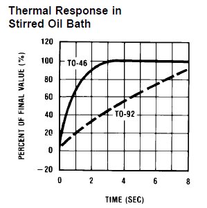

Shows the thermal response of the TO92 package for a step change in temperature. (dunking the sensor in the oil bath). Stirred oil conducts heat well, so they are measuring how long it takes the internal die to heat up through the plastic walls...
