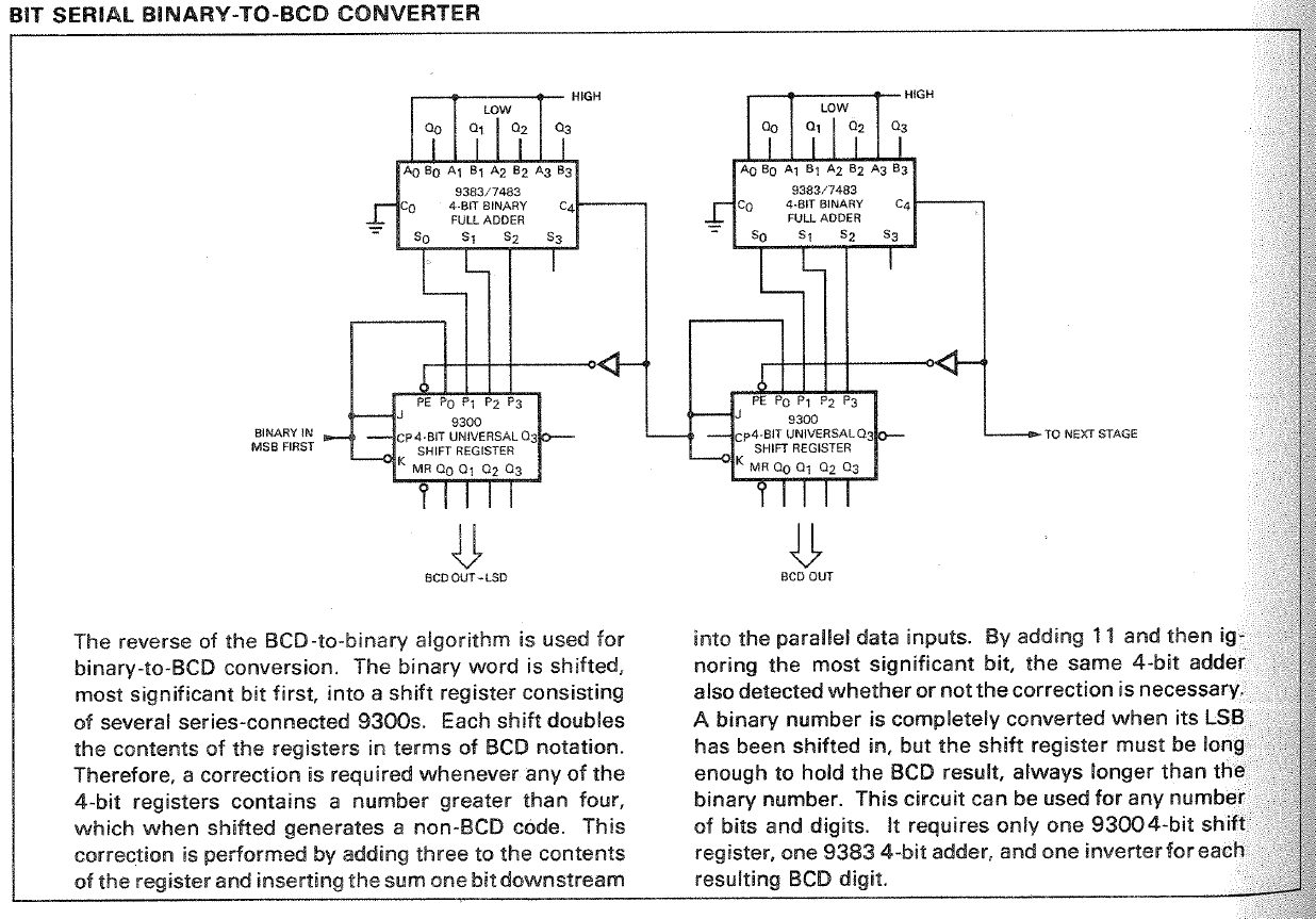

zanes said:
Is it possible to drive several 7 segment displays from a 5 bit input to display 1-31 in decimal on the 7 segments, without using a microprocessor.
Attached is an old circuit from Fairchild that uses two devices per digit to convert serial binary to BCD. You would need to add a parallel to serial shift register to convert to the serial input needed by the circuit. May be more trouble then going to a micropressor design but it is possible to avoid a microprossor if you want.
Another technique is to parallel load the data into a count-down binary counter which shares a clock with an count-up BCD counter. (See my thread at "Serial Binary to BCD Digital Display w/o uP" in the Electronic Projects Design/Ideas/Reviews forum)
