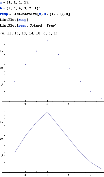

evaluate y(n)= x(n) * h(n) where x(n) and h(n) are sequences show below
do i need to multiply the value of h(n) to x(n) and shift the h(n) to the right 1,2,3 and so on?
Here's how the calculation goes. For each n you do this:
y[n]=sum[m= -inf to +inf] x[m]*h[n-m]
so this means you're doing a bunch of regular multiplications and summing the results for that n.

MrAl is correct. Modern mathematical packages often have convolution as a built-in function. For example, the attached image shows the convolution as performed by Mathematica.
As MrAl explains, x can be thought of as a signal, a square pulse in this case, and h can be thought of as the impulse response of some filter. Then the convolution is the result of applying the input pulse to the filter.
Another interpretation is that of a running average. In this case, h can be thought of as a time series, a set of data points. x is the list of weights and the result of the convolution is a running average of four equally weighted data points per average.

I have also solved the problem and I got exactly the same as what "The Electrician" has in his post.
1 2 3 4 5 6
6
5+6
4+5+6
3+4+5+6
2+3+4+5
1+2+3+4
1+2+3
1+2
1
However, although I know how to solve this, I realize that our teacher failed to actually explain what the applications are in electronic systems. It would be more interesting and easy to grasp I think if students know those things. Kindly explain in a student level the applications please.
