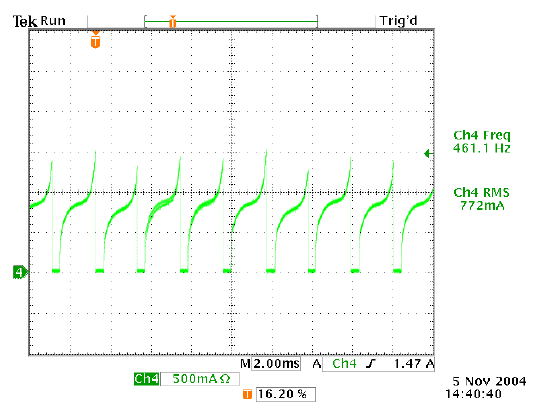

The current that you see on page 3 of the link below is highly resonant. As you know, it will draw high ripple current from the supply capacitor, that ripple current being equal to the following...
SQRT{[RMS value of the current]^2 - [average value of the current]^2}
https://www.nmbtc.com/pdf/engineering/cooling_fan_behavior.pdf
I realise that its not massive AC RMS ripple current, but when you are trying to get rid of electrolytics then it is not wanted.
Also, the problem as you can see, is that if the supply capacitor that supplies the fan is of a small faradic value then the resonant period of the supply capacitor and fan coil inductance is less than the commutation on time of the fan, and that gives problems of resonating current inside the fan which wears out its bearing.
I am sure you agree that the resonant appearance of the waveform on page 3 is the resonance between the supply capacitor and the fan coil inductance.
No I don't agree. I don't see resonance in this picture. or at least not LC resonance.
Sorry, I don't agree either. What the waveform shows is the coil current dropping to zero at each commutation, then building up due to the coil inductance. The current varies as a function of the rotation angle, due to back EMF; hence the current profile. I've obtained similar waveforms with a BLDC fan run from a 12V battery, with no supply capacitor.

The resonance on the waveform is clear to see...it curves one way then the other, like a sine, its definitely LC resonance.....it makes sense too.....you have an L and a C and they are being pulsed, and inevitably they ring with each other.
If you use a small supply capacitor, you will see the effect of the ringing very clearly indeed, as there will be multiple ringing periods within 1 commutation on time event....this is bad news and means torque pulsations and bearing wear in the fan......as well as extra core loss in the fan's core.

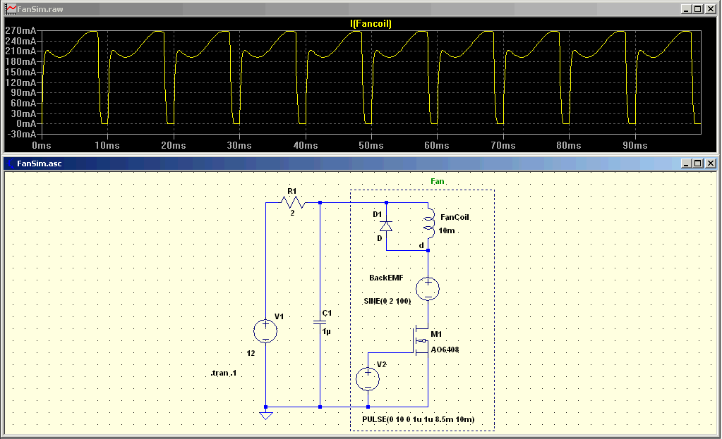

Here's my effort at simulating a fan motor commutated at 100Hz. The coil current waveform is not a million miles away from that shown in post #10 ;). You can play with varying C1, but it makes very little difference; there is no apparent LC resonance. The sinusoidal part of the curve is due to the back-emf. In reality the curve shape would depend on the rotor and stator pole profiles.

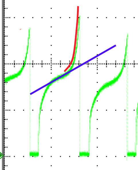

My thought:There is a oscillator in the fan. The zero current time is the dead time of the oscillator. The blue line is the inductive charging if the coils. I think the red line is the coils saturation.
There is a common power circuit, using two transistors and a transformer. The transformer is driven in one direction until the core saturates. That causes the other transistor to turn on. Saturation is the key trip point for the oscillator. Any way the current wave form is close to you motor.
