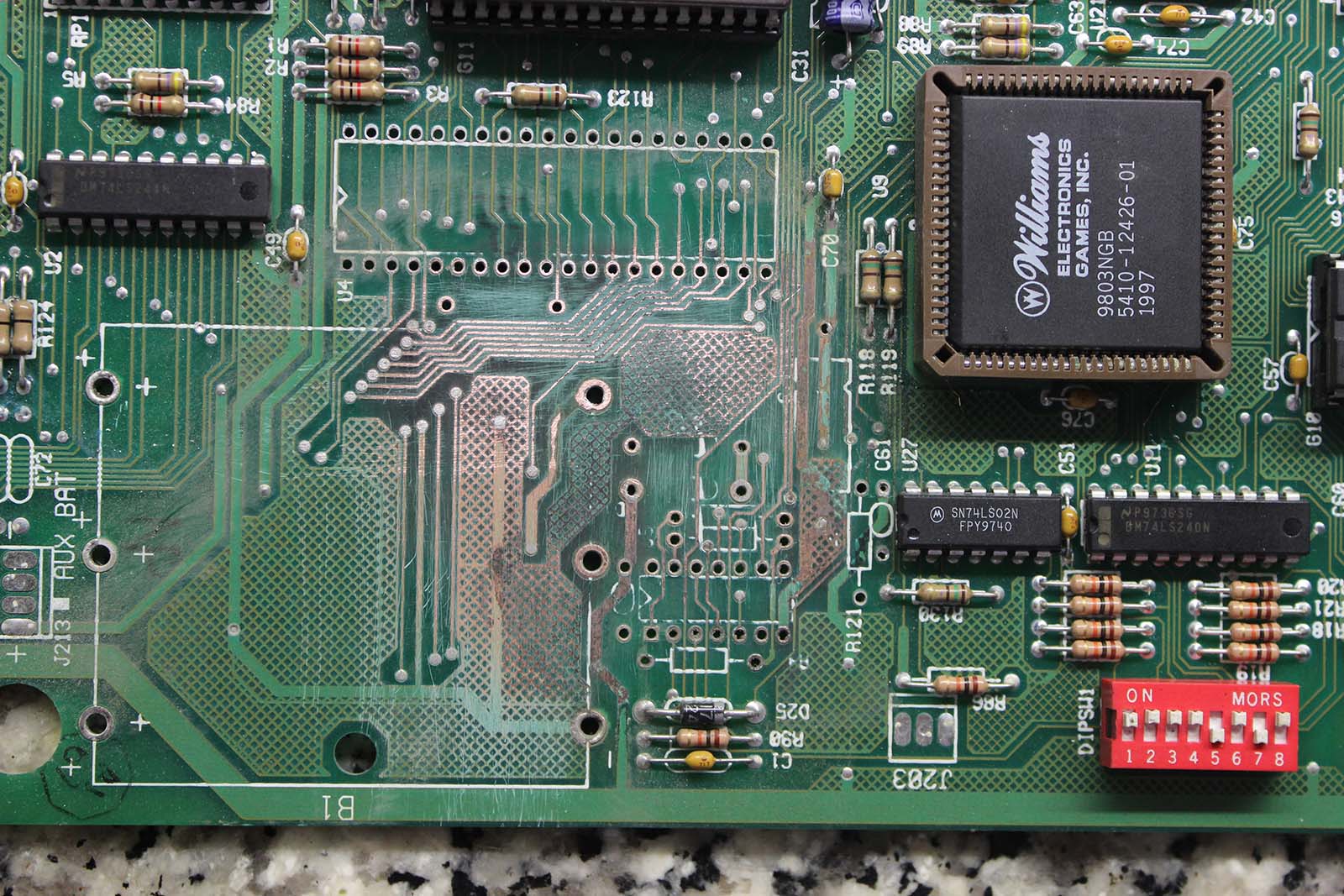

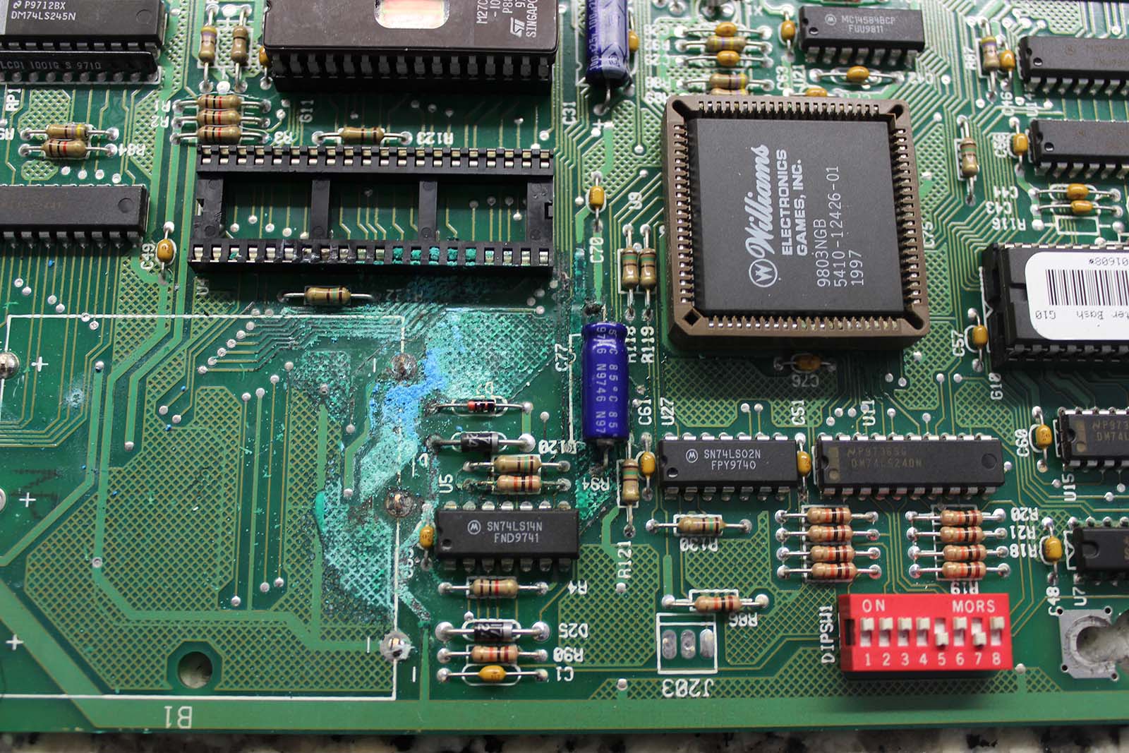

I repaired a pinball CPU board that had battery damage. Here's what it looked like before removing some components,

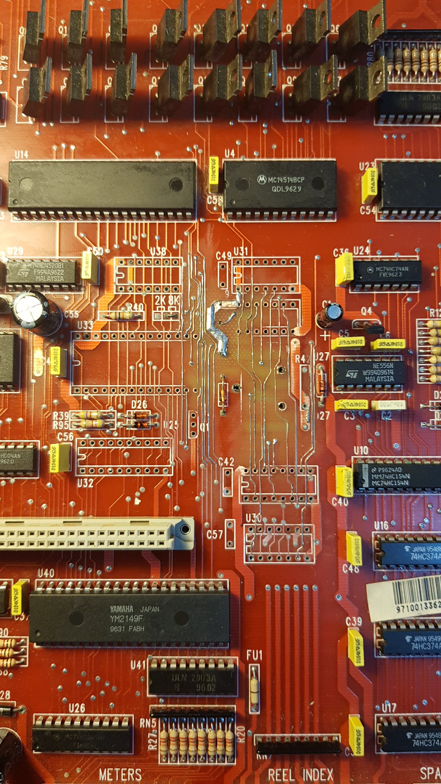

And after,
The CPU is a 6809 and, as you can see, the diagonal tracks up to the CPU were completely corroded away. I repaired those by soldering wirewrap wire on the back of the board after replacing the components. Any intact tracks (and with micro breaks) can be soldered over. Unfortunately I didn't take (or more likely keep) any pictures of the completed board. Note that the damage is alkali damage and needs to be neutralized with acid.
Edit, for some thicker tracks you can solder thin tinned copper wire onto the track.

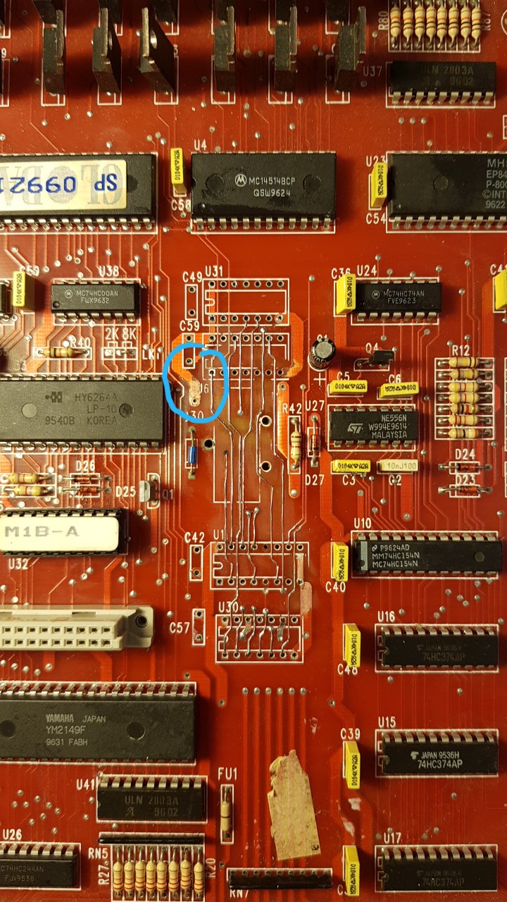

Hi the traces I just solder a wire on direct to the board. It's not the board in the picture but the area in the circle has almost totally gone.
Copper tape sounds good is it bare copper on the surface? I'll have a look today
A recent board may have traces that are too fine and close to solder wire on. The board above is circa 1995 when everything was much more spread out. You mention a picture but I don't see one.

It was late last night and I didn't get a pic of the board I'm working on. It's the same as this one in the pic. The area in the circle has totally gone. This board is worked ok. But I need a solution for larger tracks and ground areas hopefully this tape will do the job.
That picture is just to show the area and what I need to remake. That one is repaired.
As I say I didn't get a picture of the one I'm working on last night. 12:30am job
3M foil tape looks exactly what I'm after! I could not buy some fast enough!
