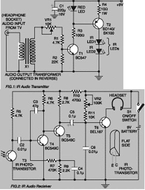

Any body has any idea about building Stereo Cordless Headphones? I want a working curcuit diagram of transmittor and receiver.

i found this on a site a while back, but i can't remeber where (sorry if this is ur diag, i appologise, feel free to tell me and i'll add credit, or remove the pic)
u will have to build two, one for each channel
admitedly, this is based on infrared, which needs line-of-sight, so isn't that useful for wandering, but it may give u some ideas
