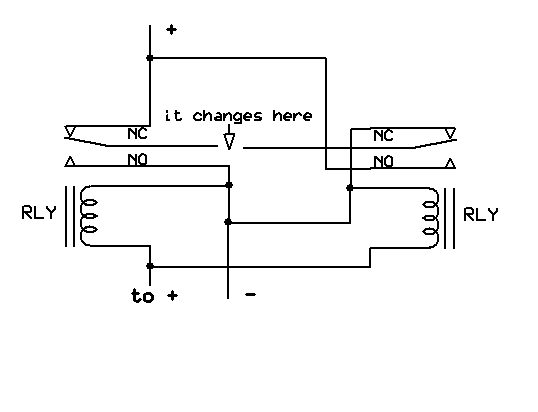

Your not going to do that with A relay it takes 2 of them to make that work
They make a switch that when you power it it will flip-flop but it's rotary not a relay.
A relay goes back to it's resting state.

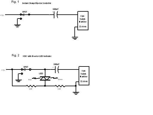

Thanks for all the info... As I am processing your responses here is the explanation of what I am trying to control.
I am building a control panel for my model railroad layout. I use KATO Unitrack switches which are DC switches that are controlled by 2 wires(black and red). To throw the switch you ned a momentary +- signal and then to throw the switch the other way you need a momentary -+ switch. It works just fine with a DPDT Center Off Momentary switch. Depending on which way I press the toggle it will control the track switch.
Because this is controlled by a momentary switch you never know the direction the track is going and this is where the relays and diodes come into play.
So, I thought that I could get a relay that will turn on a diode and turn off the other as I send the momentary signal, but the momentary signal changes polarity.
Also, I tried the BCD circuit (Bipolar Capacitor Discharge) but I get a lot of noise from the switch when it is thrown in one direction. If I could figure out the reason I am getting the noise from the coil in the track switch this might be the best way to go. Also, in this circuit I am using SPDT Momentary switch. Attached is the BCD circuit that I used.

I was able to find a resolution to the BCD circuit so I will not need a relay to control my directional diodes.
The issue with the buzzing noise coming from the switches had to due with "dirty" DC power coming from my power supply. A simple addition of a capacitor fixed the problem.
