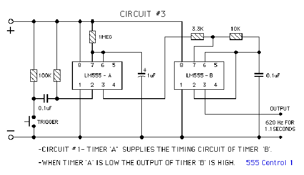

could this circuit work, using 555 to make a phone call
haxxx
Novice here,
I want to build a circuit that will employ 2 relays, one to close and release the speakerphone button on my telephone, then 1/2 second later the second relay would close then release the redial button. The phone requires the release of the speaker phone button b4 it allows redial. Could the attached circuit work by connecting the speakerphone relay to the output of timer A, then the redial relay to the output of timer B. or any other ideas.
Thanks,
Haxxx.

No that circuit won't work. It provides a beep tone once the left 555 is triggered.

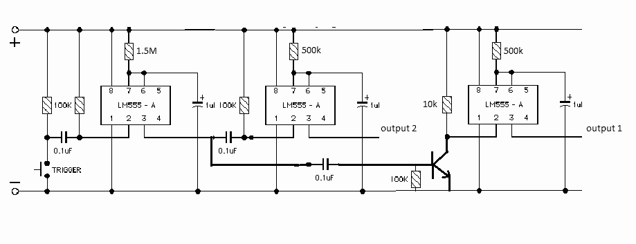

You can do it with 3 555s, each configured in the monostable timer mode:
1) the first 555 is set up just like the left one in your schematic, mono time constant = 1.5seconds,
2) the second 555 is triggered from the output of the first though a capacitor, mono time constant = .5seconds,
3) the third 555 is triggered from the output of the first through a capacitor & inverter (e.g. a transistor inverter), mono time constant = .5seconds.
The outputs from the 2nd & 3rd 555s will be the pulses that drive the relays.
The way it works is the 1st timer outputs a 1.5second pulse; on the rising edge of this pulse, the 3rd timer is triggered & it outputs a .5second pulse. On the falling edge (i.e. after 1.5 seconds), the 2nd timer is triggered and outputs a .5second pulse.
Hope you can understand my ramblings.

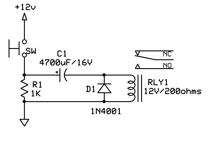

OK what you need is two momentary relays one with a delay.
May be something like this;
I would use reed relays with the diodes built in and a 555 timer for the delay on the 2nd momentary relay.

If the above doesn't work, here's my original proposal:

One more quick question, a couple years ago i built a 555 circuit very similar to the one on the left. I was advised to
place a diode across the 100k to prevent the voltage at pin 2 from rising above the supply voltage when the cap discharges,
just like to know if it's necessary over overkill.
I can see where they were coming from; when the switch is released, the capacitor could potentially go to twice the rail voltage. Personally: I wouldn't bother, as the current is limited by the resistor that's connected to the switch (value not marked, but should be between 10k-100k), and the BJTs on the input should zener away any excess happily. Professionally (if I'm allowed to use that word): if I were worried, I might run some checks on the induced spike or just simply add the diode. But really, go for your life; diodes don't cost much & adding them certainly won't hurt.
