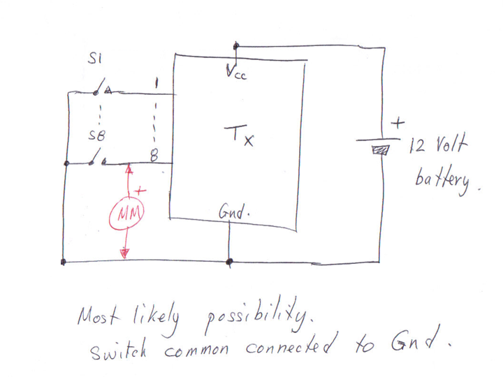

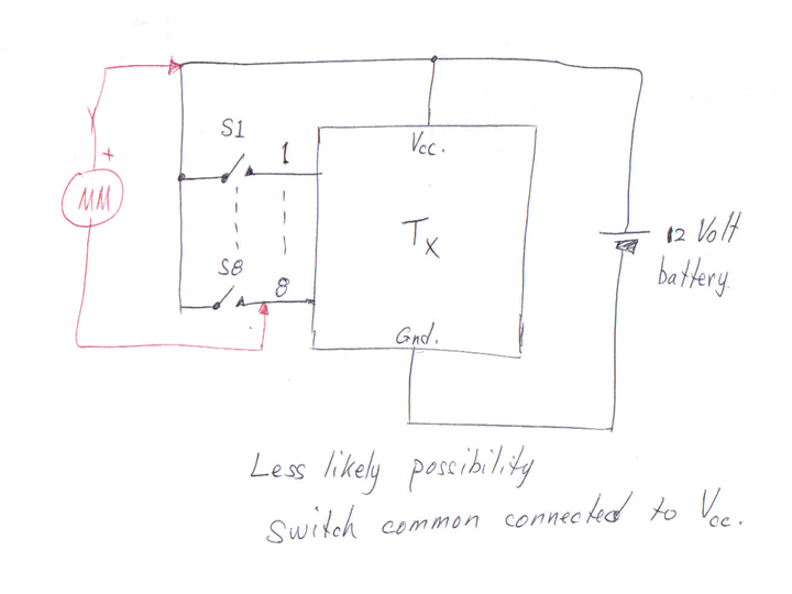

Sean,
As I understand it, you have 8 leads that are the code input leads. In my garage door opener, I have 12 leads that go to the DIP switches on which I set the code.
I don't know if you have switches or not, but it does not matter. If you do, then switch one switch to the open position and measure the voltage across it (you won't see any voltage if the switch is closed). Then switch the MM to current and measure the current.
If you don't have switches, then connect the MM across one input as you would connect a switch.
I'll draw a diagram and post it later. A picture is worth a 1000 words.
If the number of combinations was quoted as 3^8, this would imply that it is a 3 state system which seems VERY unlikely. Perhaps it was a misprint.
EDIT. Here are 2 possible arrangements. There are other possibilities, but consider these first and let us know if your system fits one or the other or neither.

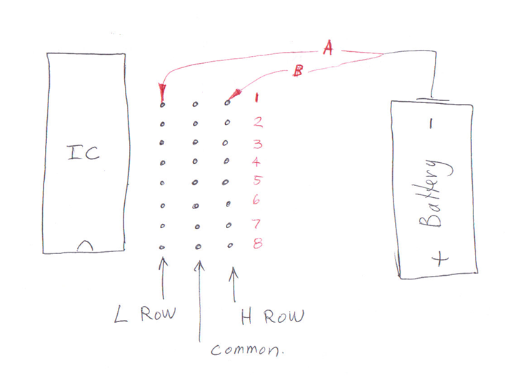

Here is a picture of the Tx board. This side of the board has the jumpers for the encoder chip. If you look close you can see that there are three rows of pins. The jumpers are not used in the picture, they are just sitting on one of the right pins. The right row is the High row, the center row is the common row and the left row is the Low row. Measuring the voltage with 1H jumper-ed (A) gives me 8.5v at the start and then it drops to 7.6v the amps at the jumper are 3.5mA. Doing the same with 1L jumper-ed gives me 0.04v and 0.05mA
Just for clarification, leaving 1L jumper ed and all of the positions on the receiver open results in the Rx not responding. Therefore I have three possible combinations for each of the eight positions or 3^8 combinations.

It is difficult to see the fine detail in the photo, but it gives me a general idea. So I've drawn the attachment to clarify.
Is there a number on the IC?
I don't understand what you mean by :-
"Measuring the voltage with 1H jumper-ed (A) gives me 8.5v at the start and then it drops to 7.6v the amps at the jumper are 3.5mA"
Do you mean that you measured the voltage with a jumper inserted between 1H & 1C?
What caused the voltage to drop to 7.6V?
You measured a current of 3.5 mA. Was this between 1H and the - battery with the jumper in or out?
You also said :- "Doing the same with 1L jumper-ed gives me 0.04v and 0.05mA"
So I assume you mean you measured the voltage and current at 1L with the jumper inserted between 1L and 1C.
How is the code set in the Rx?
I suggest that you remove the jumper from row 1 and measure the voltage on 1L, 1C & 1H.
Does your Multimeter have a continuity setting?
If so, remove the battery, connect the Negative probe to the - battery spring and see if there is a connection to 1H, 1C and
1L. If it does not have the connectivity function, then use the lowest resistance setting and measure the resistances between these points.
Can you see the tracks on the other side of the PCB? If so, take a photo of it.
Which pins are connected to the IC? ie. the L row, the C row or the H row. I suspect it will be the C row.

There are three numbers on the chip
PT2262 - 1SD38Z - KBCS6
The MFG is PTC
Correct, I had a jumper connecting the two. It started dropping as soon as I measured the voltage. However, I just realized that I wasn't doing it right. I was measuring the voltage with the - probe on the spring and the + probe on the pins. I also didn't get a reading unless I hit the transmit button. So, Here are the readings done the correct way, no jumpers; bat + to L1 = 10.45v, 162mA; bat + to C1 = 8.85v, 2.6mA; to H1 = 9.25v, 0.9mA
I measured the resistance between the - spring and the pins with the battery out. L1 = 0.2 and the other two were open
In, See above.
It is set by soldering a connection between the pins of the IC and a puddle next to it, there are rows of puddles like the rows of pins on the Tx. I plan to add an eight position DIP switch to allow easy selection.
I can't get a picture that is decipherable. It looks like the H row goes to pin 5 on the left side of the IC as seen in your drawing. All of the low pins are obviously connected but I think the connection to the circuit is on the other side of the board, covered by the pins. This PCB has traces on both sides.
I hope that answeres most of the questions. Sorry about the screw up the first time.
