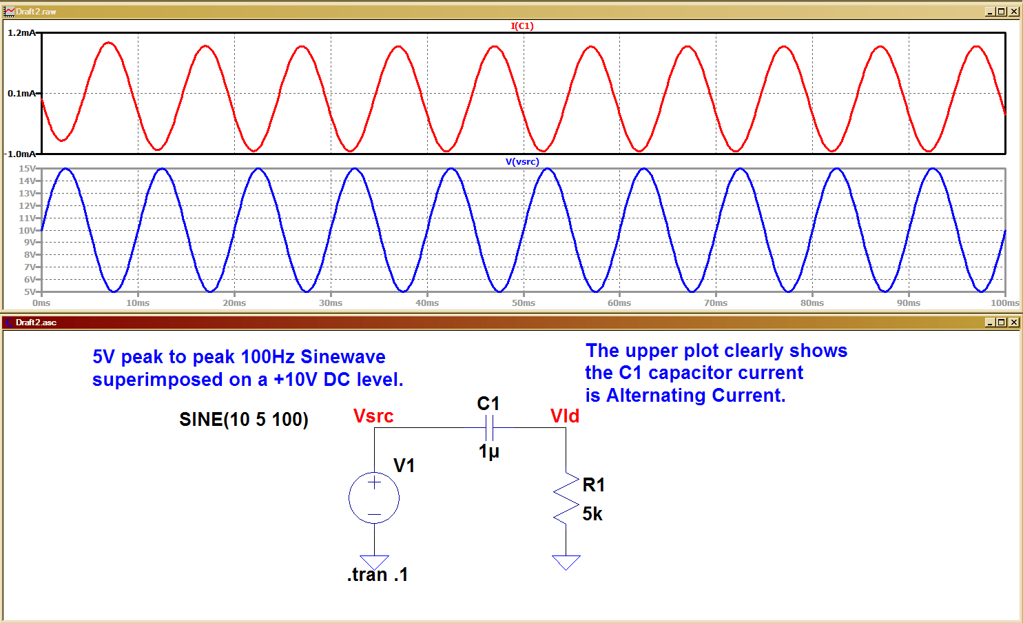

WRONG!If a voltage does not dip below zero volts, it isn't AC
Simply use an output coupling capacitor feeding a resistor connected to zero volts.So, how does one obtain an AC audio signal (centred on zero volts) from a circuit powered on a DC voltage?
Of course AC can also have a DC voltage. It does not need to go positive and negative. It just needs to alternate up and down.How can you have an AC signal riding on a DC voltage? It's not AC if that voltage does not go below zero volts - it's simply a pulsating DC voltage.
You are mixed up.The question I have, is that is the signal output (via a capacitor) from a simple transistor amplifier a true AC signal (as in, voltage is centred at zero volts) or is it that the lowest value in the waveform is actually zero volts, the waveform itself being at or above zero volts, never below.
